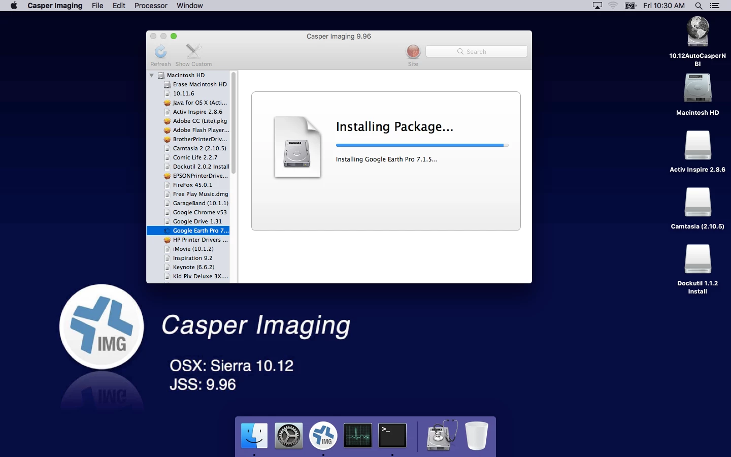

Hello All,
Just finished upgrading JSS to 9.96. This means it's time for me to create an updated NBI image with an updated Casper Imaging App. Used AutoCaserperNBI (Thanks to @bentoms for a wonderful piece of engineering) and Auto DMG to go through the normal workflow. Created the NBI, uploaded to :
OS: 10.12 Sierra (Build 16A323)- Downloaded today
Casper Imaging App: 9.96
Auto DMG: v1.6 (Build 452)
Jamf NetBoot/SUS Appliance: Version (....um....it's been a while since i updated)
Issue: DMG installer in the netboot environment are not unmounting. (see Screen Shot)
I have tried unmounting manually but they do not unmount. Also my image used to finish in about 20 minutes....now i'm going on 30 minutes and it's only half way done.
Anyone see this?

I just noticed:
10.12.1 NBI with 10.12.1 image = works fine
10.12.1 NBI with 10.12.0 image = see the dmg issue
10.12.1 NBI with 10.11.6 image = see the dmg issue
10.11.6 NBI with 10.11.6 image = works fine
  • 44 replies
  • December 16, 2016
Just revisiting this. Was seeing the same thing whereby dmg's were not unmounting and taking an eternity to install. Updated the Base OS via AutoDMG to 10.12.2, created NBI via AutoCasperNBI (1.3.4) and JSS 9.96. No longer seeing dmg's mounted on the desktop, pkg's and dmg's are installed in expected time which is good. When machine reboots it kernel panics which is not good. Tested this consistently on multiple machines. Anyone else seen this behaviour ( he says hesitantly as 10.12.2 was only released a couple of days ago)?

@TJ.Edgerly Revisited this again and found a rogue package was causing the issue. Re-packaged the culprit and also changed it's status to install on first boot instead of at imaging time. Luckily it was one of the first packages I checked so didn't have to trawl through the lot. I started off with just a base image then added from there until I hit the KP. You may want to check that if you are still having issues.
Cheers
