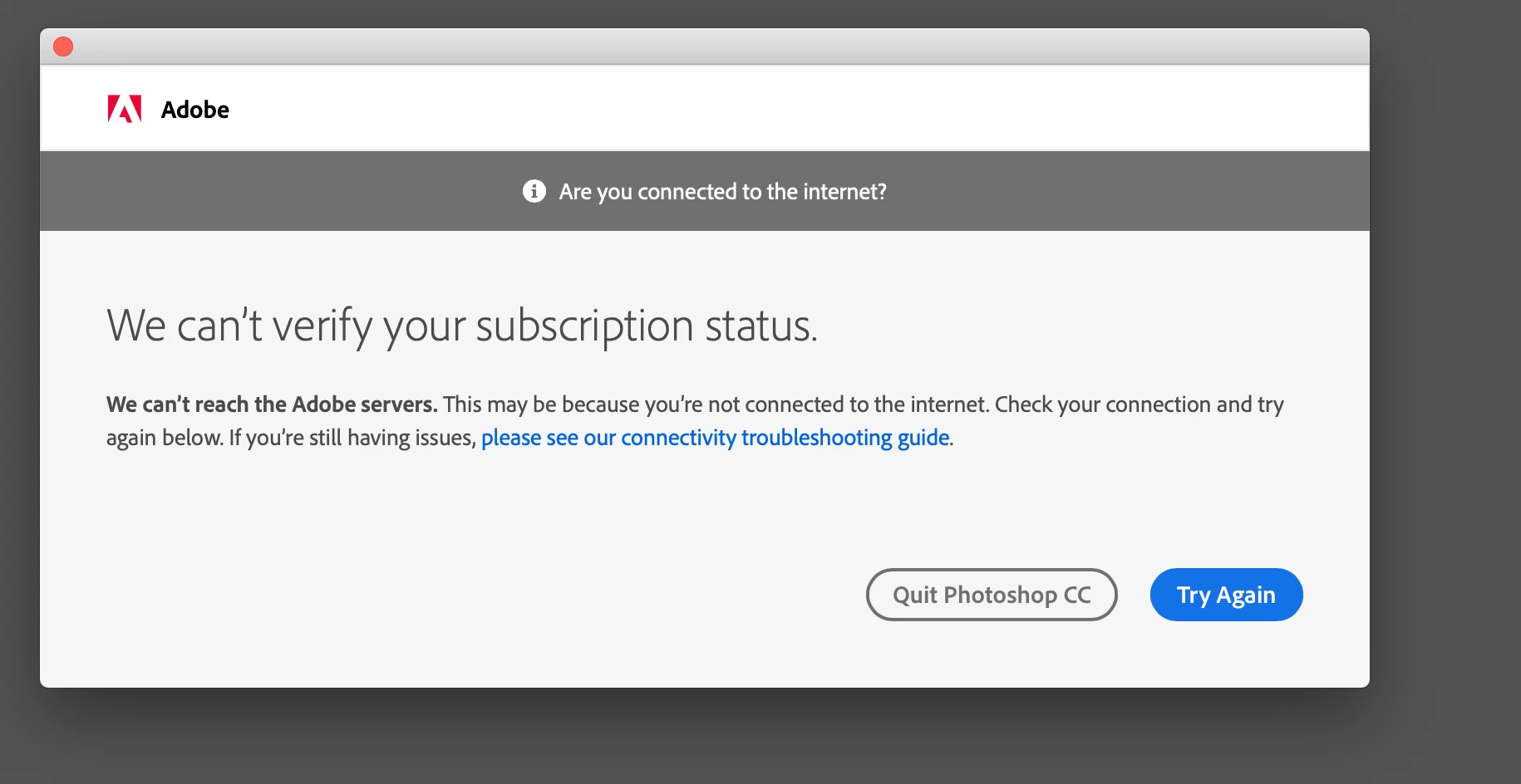

One gotcha of SDL licensed packages is you can't install more than one SDL package on the same computer. Well, you can, but then you'll get an error similar to the one pictured above about not being able to verify your subscription. So you can't do it as an "a la carte" style deployment where you create packages for each app and then assign them as needed, you have to create bundle packages with all the apps you need for each area.
On that subject, does anyone know if there's an easy way for me as an administrator to add an app to a machine where I've already installed an SDL package? I really don't want to have to deploy out a whole new 11GB apps bundle.
