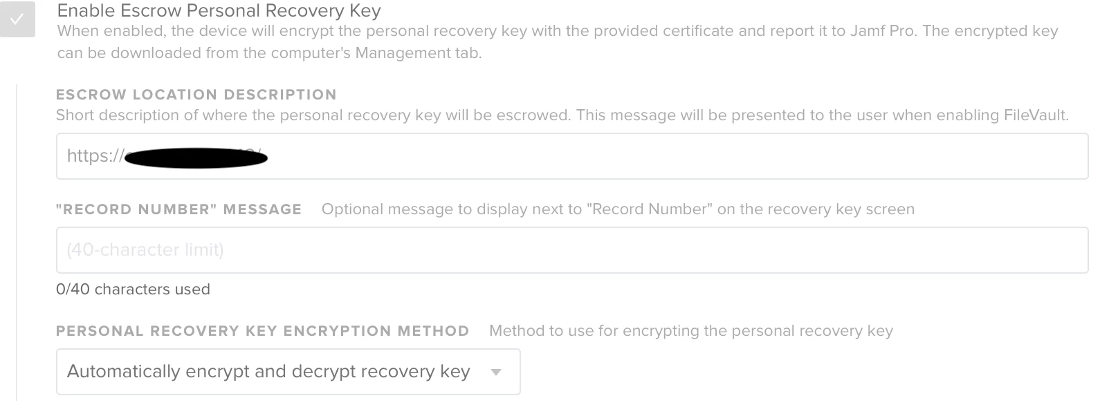

Hey, just a question, first have you ensured you set the Escrow option I the payload to redirect key to your Jamf server? Tis is required going forward with 10.13.3. Basic redirect function only wrks with 10.2 machines or older..See image below:

Hi, yes, thats all set and the other Macs are fine, again on 10.13.*

I just have "Enable Escrow Personal Recovery Key" as it was my understanding that was what was needed for 10.13.*
