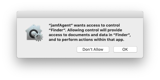

Hi All,
Doing some testing on Mojave, and when I execute one of my self service scripts (that mounts a network share...) I get the "jamfagent" wants access to control finder. etc. Message. I thought this should be covered by the Privacy Preferences Policy Contol profile that is installed with Jamf Pro 10.7.1. The profile is there, and the settings appear correct.. Is there something else I have missed?
Thanks,
Tim

I'm running into the same issue, and I'll be evaluating all the scripts and configurations. I do have some scripts running "jamf policy -trigger "custom-trigger"

You will need to make additional pppc profiles if you are running scripts.
The default payload just deals with what JAMF needs to be able to run.
It does not take into account any scripts or actions you may be taking in policy

Try uploading this to your JSS. Some of the speaks at JNUC 2018 provided it during the tcc session. It's worked for me so far.
https://github.com/jamf/JamfPrivacyPreferencePolicyControlProfiles

Have a look at my old thread here. It should have most details.
https://www.jamf.com/jamf-nation/discussions/29605/pppc-utility-question-on-best-practice-to-create-config-list
