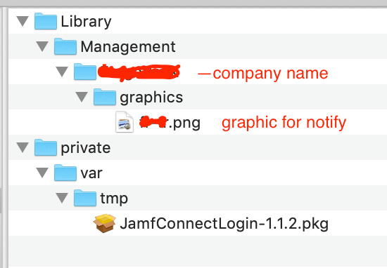

personally rather than repackage jamfconnect I just drop it in my own wrapper package, meaning I don't have to mess around with it each time it's updated, I just update the wrapper. Less chance of any issues.
I also deploy the graphic(s) for using with Jamf Connect Notify in here.
then in the post install script I install JC, setup initial notify values then sort out the login window;
