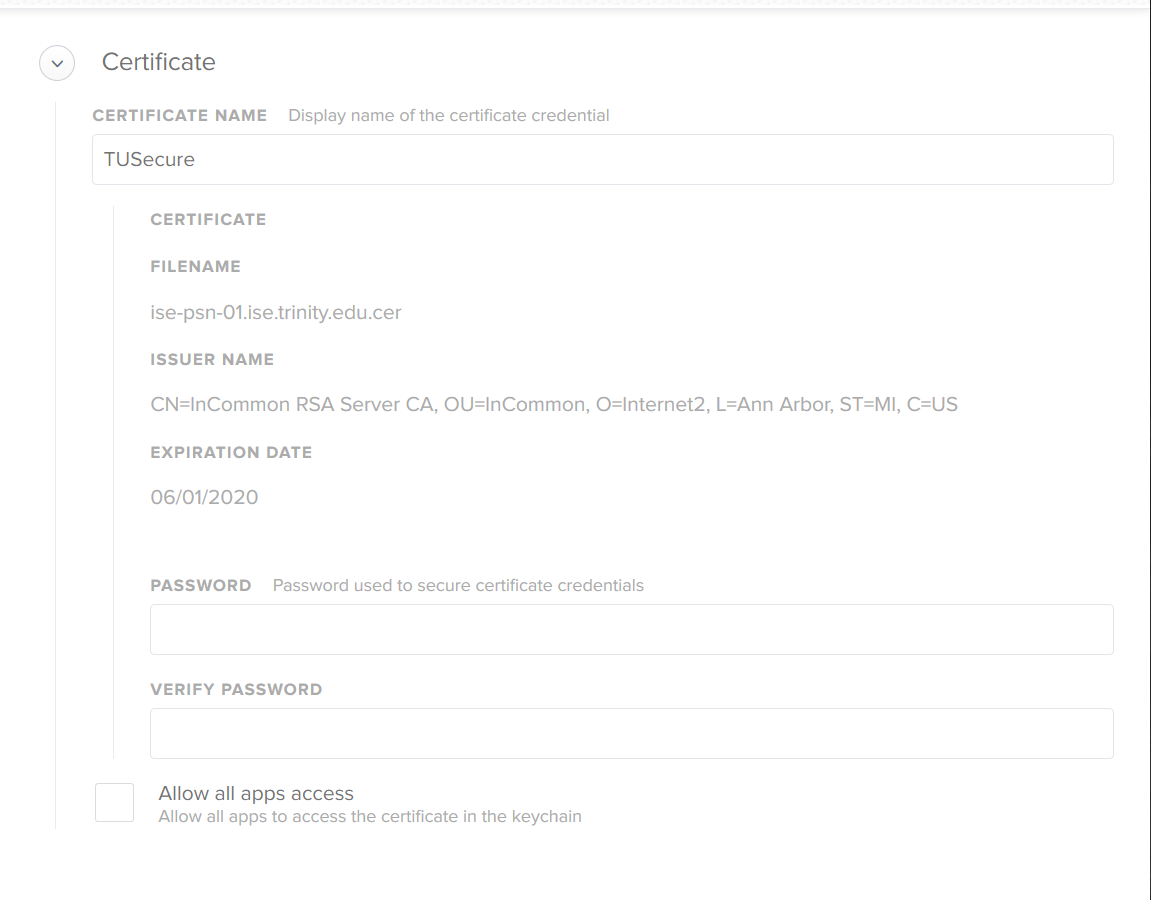

Since the renewal, our issuer has changed and AD logins no longer work. I thought it would be as simple as putting the new cert in the configuration profile and be done with it. Sadly that wasn't the case, and I believe it is because the certificate roots are from a different CA. That CA is also not included in the System Keychain by default (not sure if this is relevant?)
I have tried deleting the old certificates relating to our expired 802.1x cert and the CA certs as well as pushing all the new certs in a configuration profile. No dice.

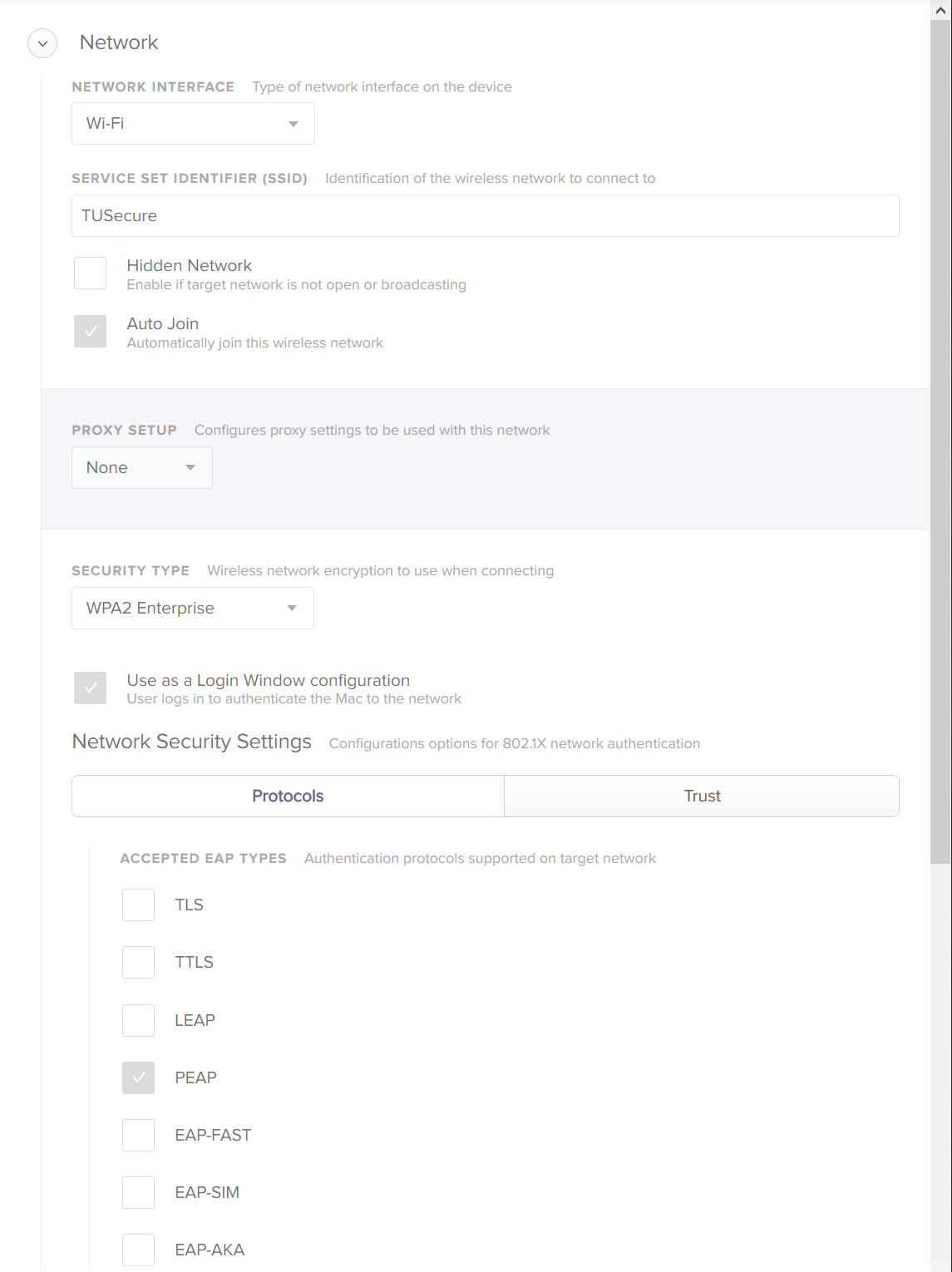

I believe your certs need to be in the same payload as your wireless settings and you need to go to the Trust tab in the Network payload and trust those certs. Also, you may want to try EAP-TLS instead of PEAP.

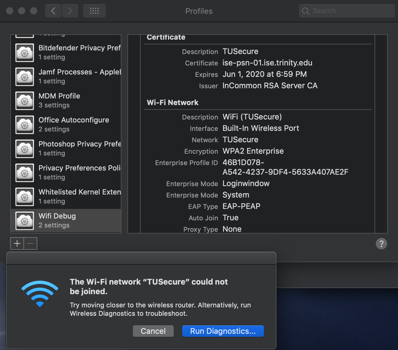

To remove the old WiFi Profile we have been connecting to a guest network so the JSS can send the new one,
I have changed nothing in the profile except updating the certificate.

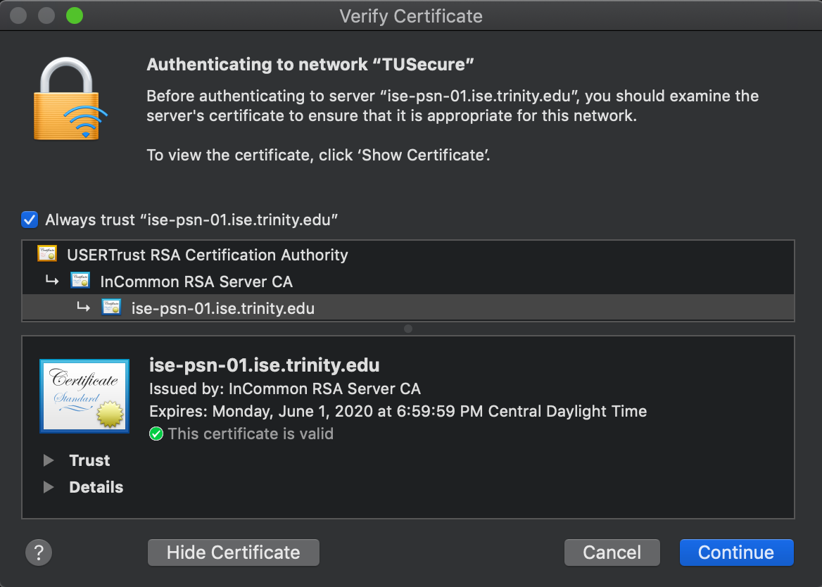

The rest of our macs that aren't using AD had this issue too, but the solution was to go into the Keychain and delete all certs relating to "ise" and "DigiCert", except under System Certificates. I only use this profile on our lab laptops so students can login through AD, thus the problem is isolated to those machines only. What seems to be happening is at the login window it's not actually able to connect to the network anymore.
If you delete the certificates and connect to the network manually, it will then download the new certificates and everything is fine. If you push the Configuration Profile with the certificate, it fails to connect.

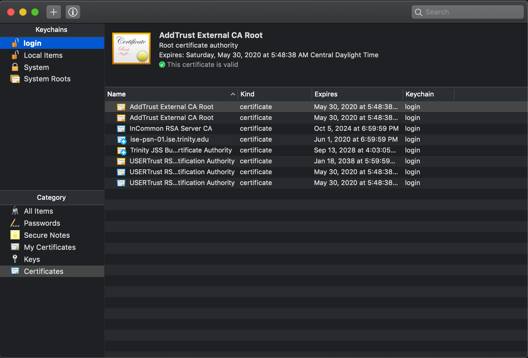

Basically it just has the "ISE" cert and settings for the WiFi network. We changed providers so the CA has changed. That CA is not included in the System Roots store, which I suspect is the problem, but even when pushing these as well it still gives the same
When connecting manually however, everything seems to work without a hitch. The "Login" keychain for "Certificates" was empty excluding the JSS cert, until accepting the "ISE" cert for WiFi. the keychain is then populated as so
I have tried deploying all of these certificates through a configuration profile with still no success.
It all works PERFECTLY when you manually connect, but when you do it this way, AD users cannot login because there is no WiFi at the login window.

Adding the network certificate to the Trust option resolved this issue. Thank you much!
