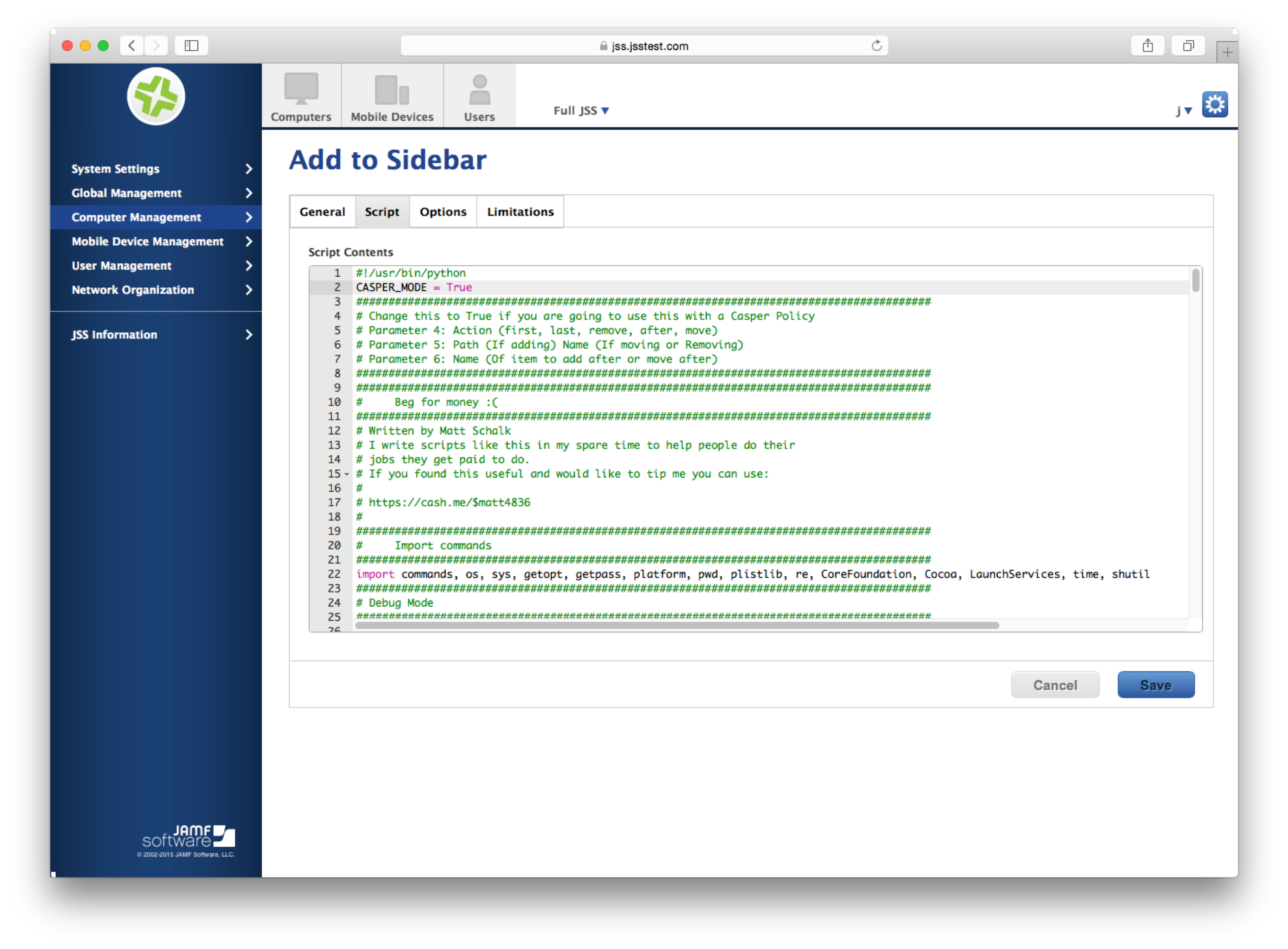

@gfawkes After goofing with it all day I was able to get working properly with Casper.
Be sure to use this version
Be sure to change line 2 to True

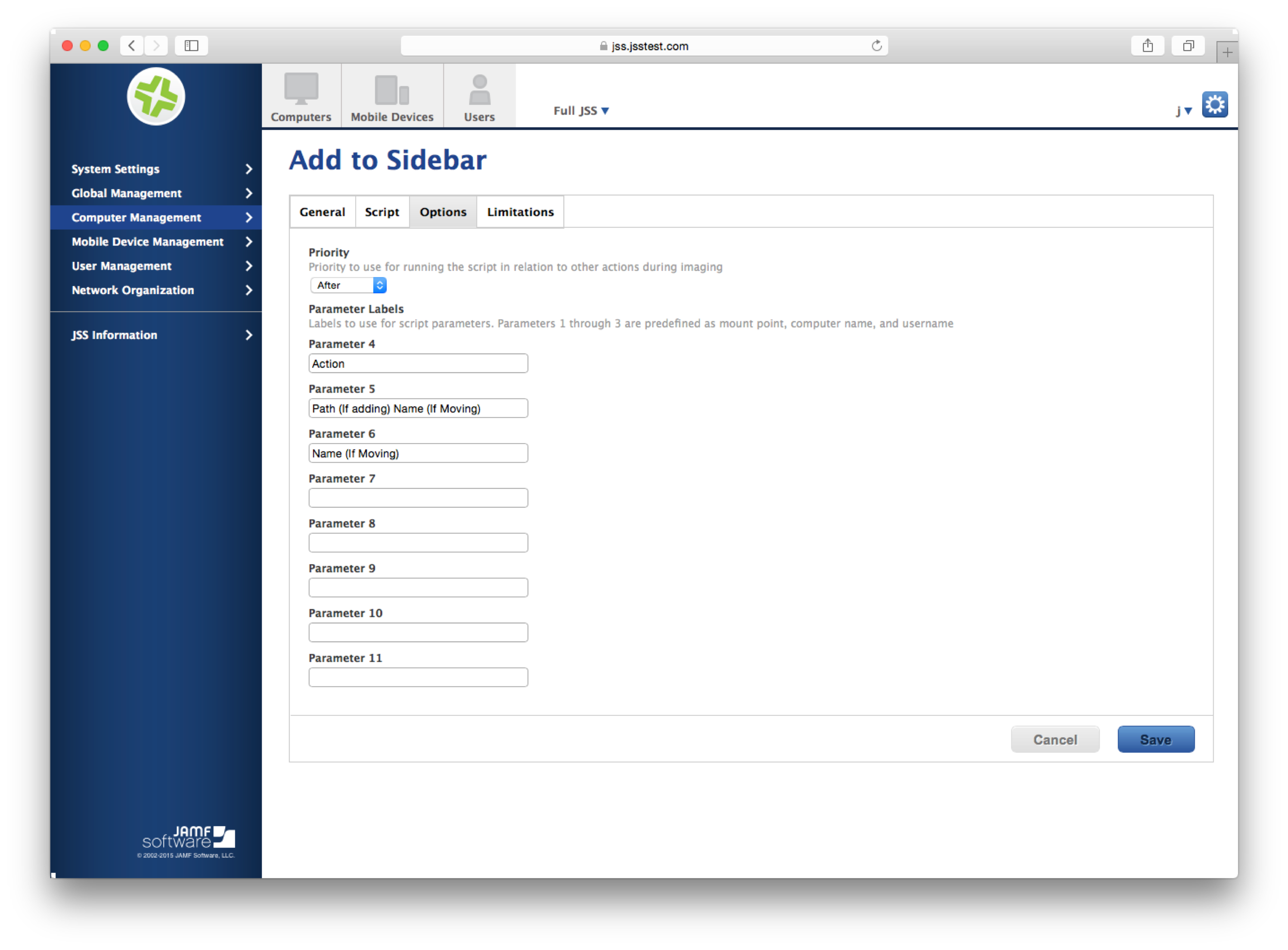

  • March 27, 2015
Rename your Parameters

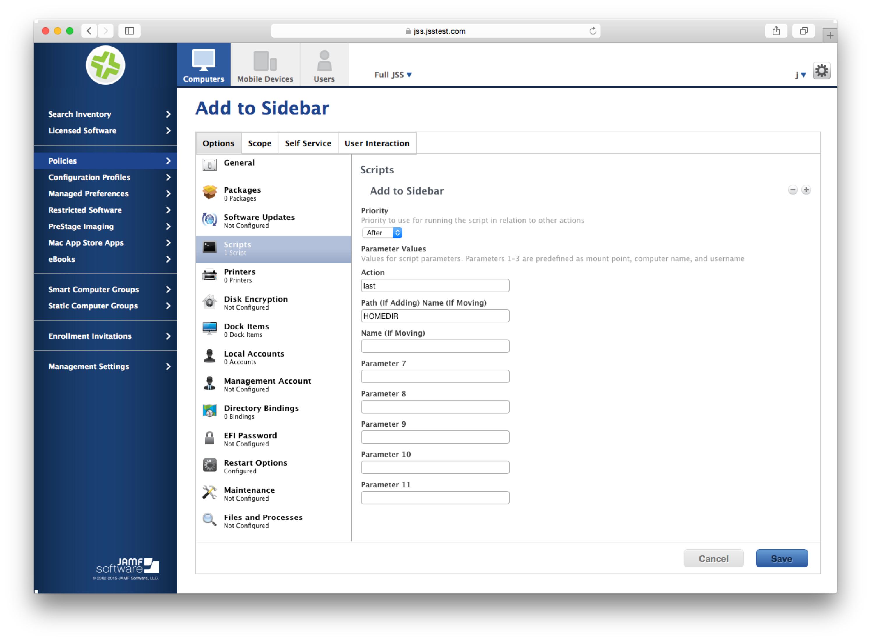

  • March 27, 2015
Here is adding a item to the last position

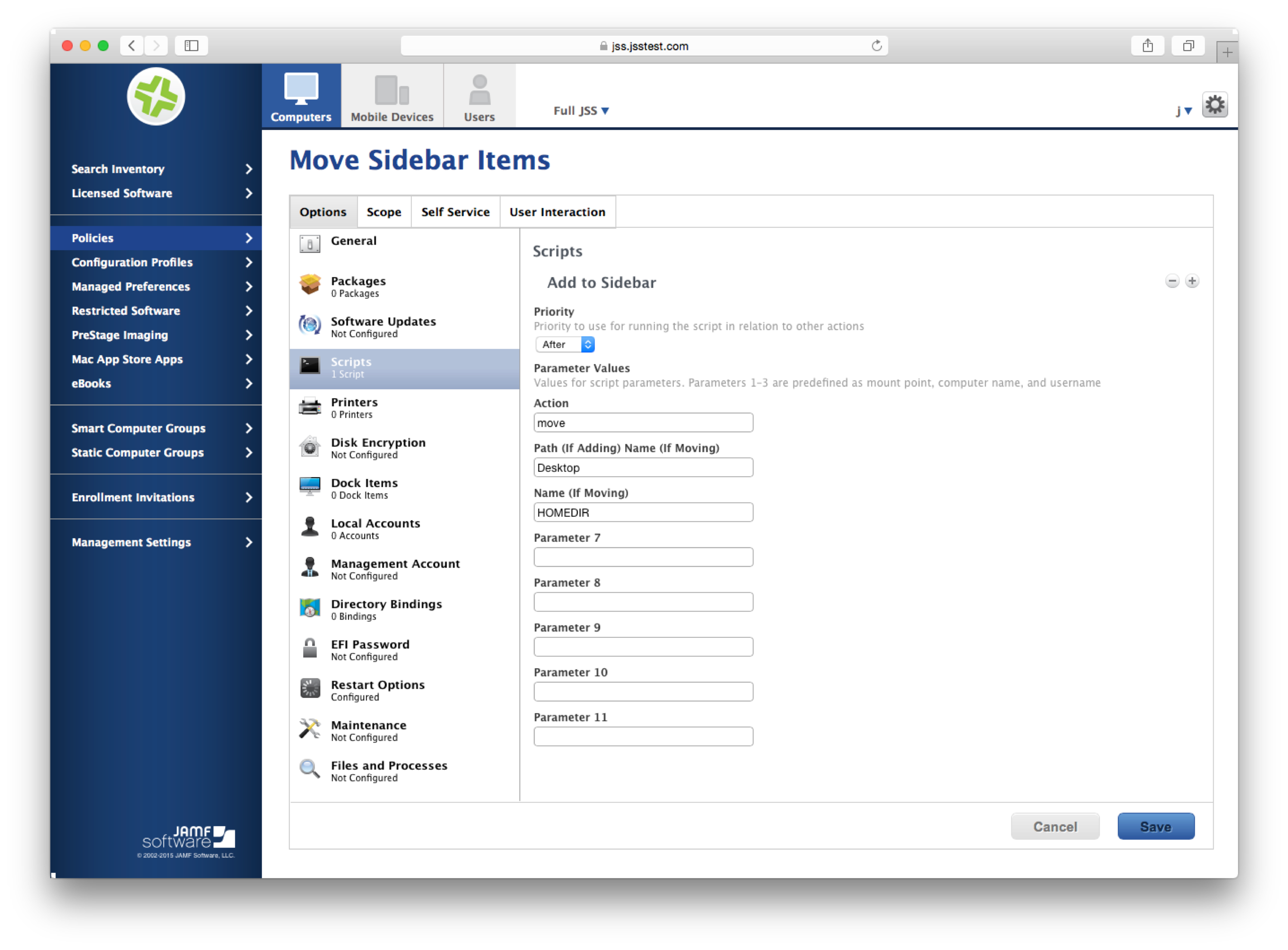

  • March 27, 2015
Here is moving an item

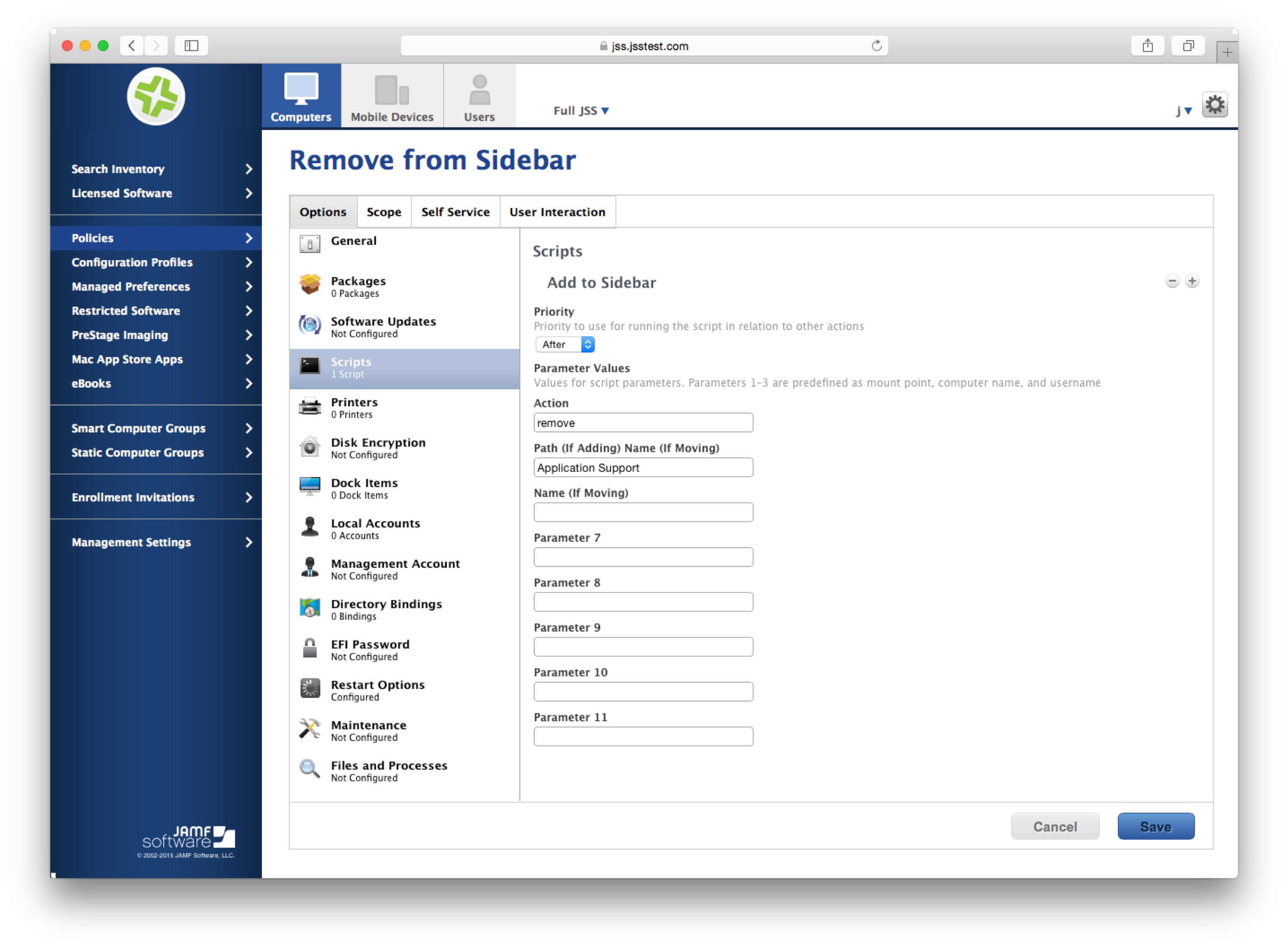

  • March 27, 2015
Here is removing, notice you use the name not path!
