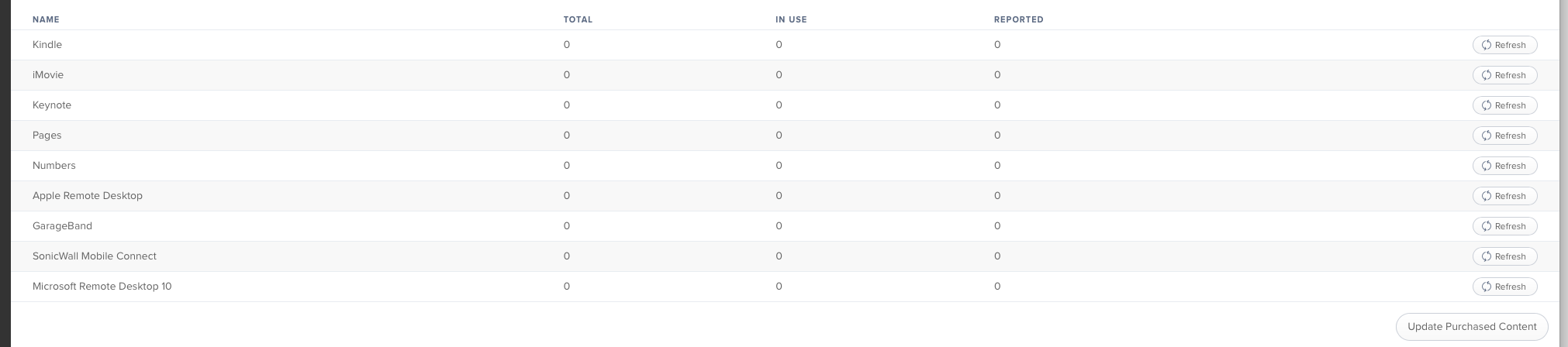

My total Licenses for my VPP accounts (Settings>Global MAnagement>VPP Accounts) are fluctuating from the expected number to 0
tons of this in my logs:
VPP License with adam id xxxxxxxxx has been transferred to a different VPP token

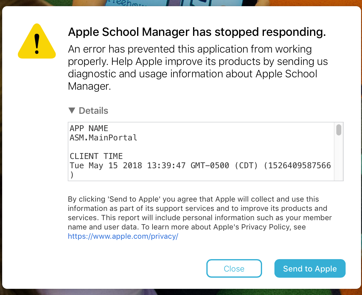

and in ASM:
and for humor:

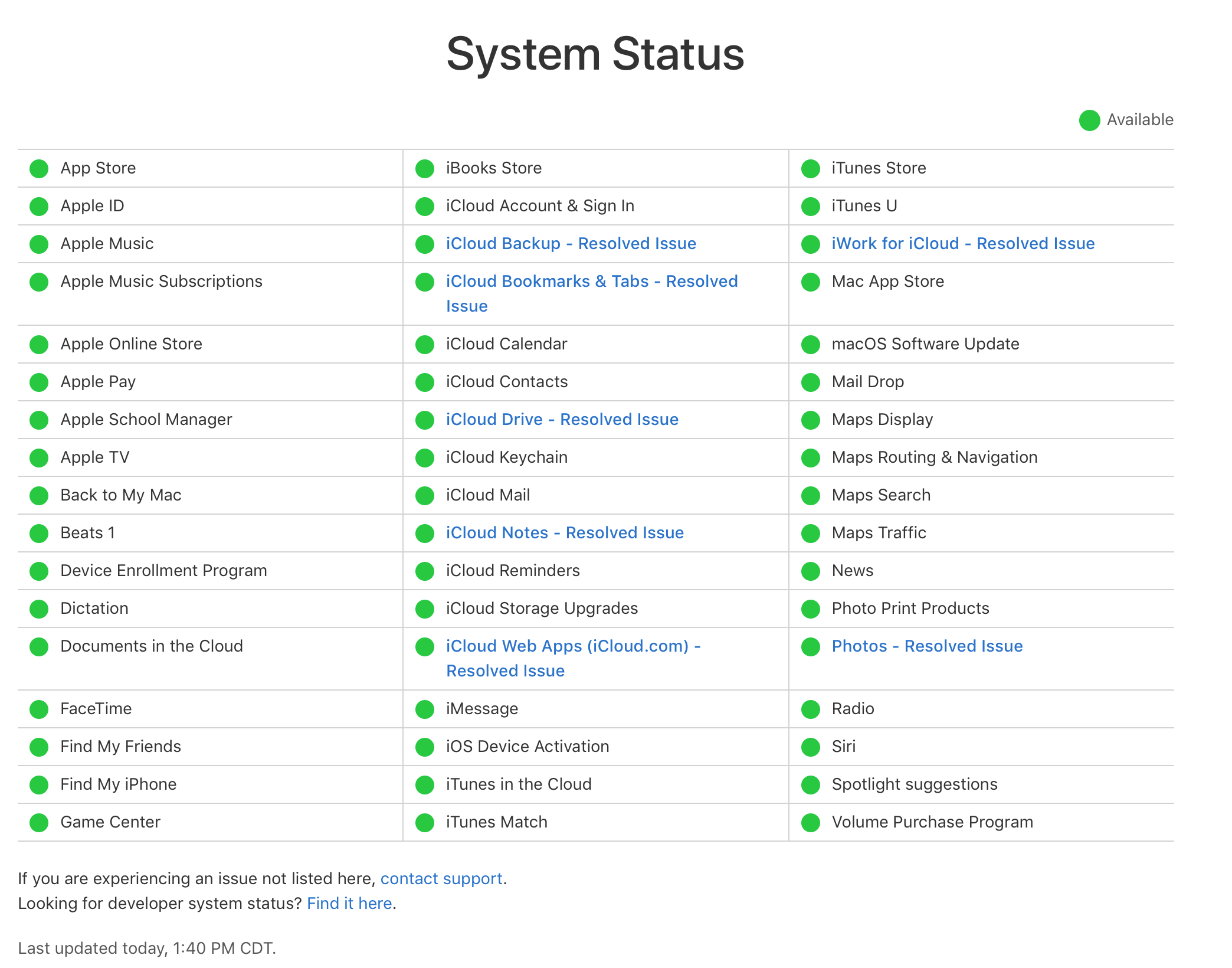

I talked to Apple this morning and they are working on the Error.
Their tech tried and he got the same error.
Then he sent the ticket to the engineers.
Told me to keep checking every so often to see if they have fixed it.
  • May 16, 2018
Just checked and it is working now.
