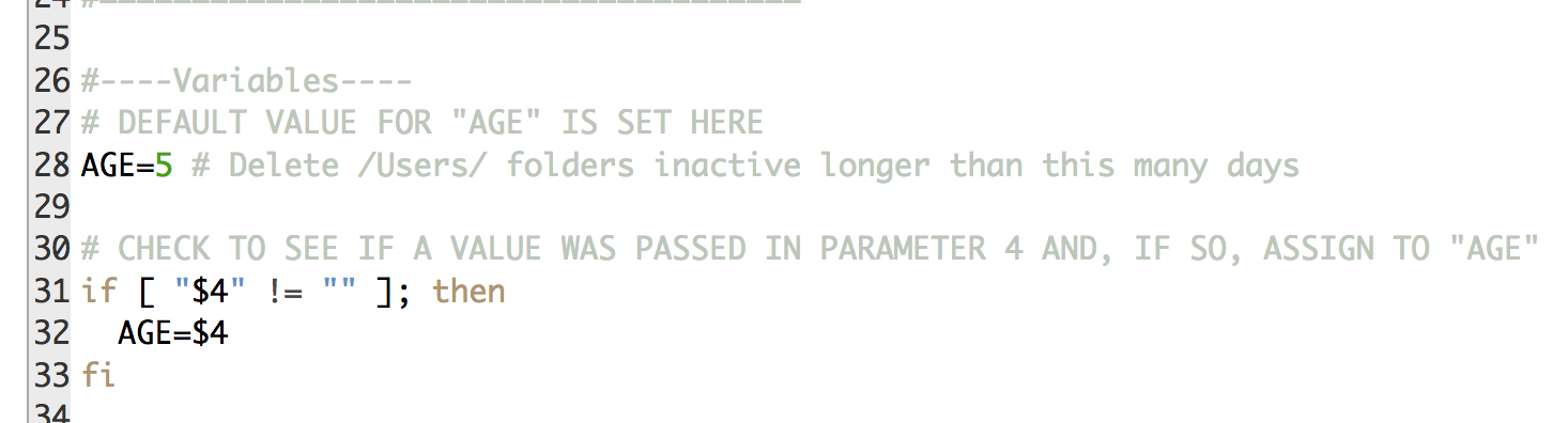

I was just testing the script posted by@mscottblake and I'm not sure if I did something wrong. I have the script, changed it to 5 days to test deleting some older Users on a machine. The policy is set in Self Service and available with JSS login credentials matching jamf_admins or help_desk. I logged into the computer as a student standard account then launched Self Service. Logged into Self Service as a user in jamf_admin so I could see and run the policy. Once the policy ran it kept the users I wanted, Shared and local admin but it deleted all the local user accounts including the student one I was logged in as, I watched the Desktop items disappeared. I logged out of the user, logged in as local admin and checked System Preferences, the only accounts left were the ones in the script I excluded.
What I was hoping is that it would leave the current logged in user alone. Maybe I misinterpreted the script but I would think the current logged in user would have a modified date of today so it would ignore current logged in user.
Is there a way to add "Users/~CurrentUser" as a user folder not to delete.

@richeames Sounds like you age date is not set properly. What do you have set in Parameter 4 in the script options?
  • April 4, 2017
Screenshot from script. Age=5
Thanks,
