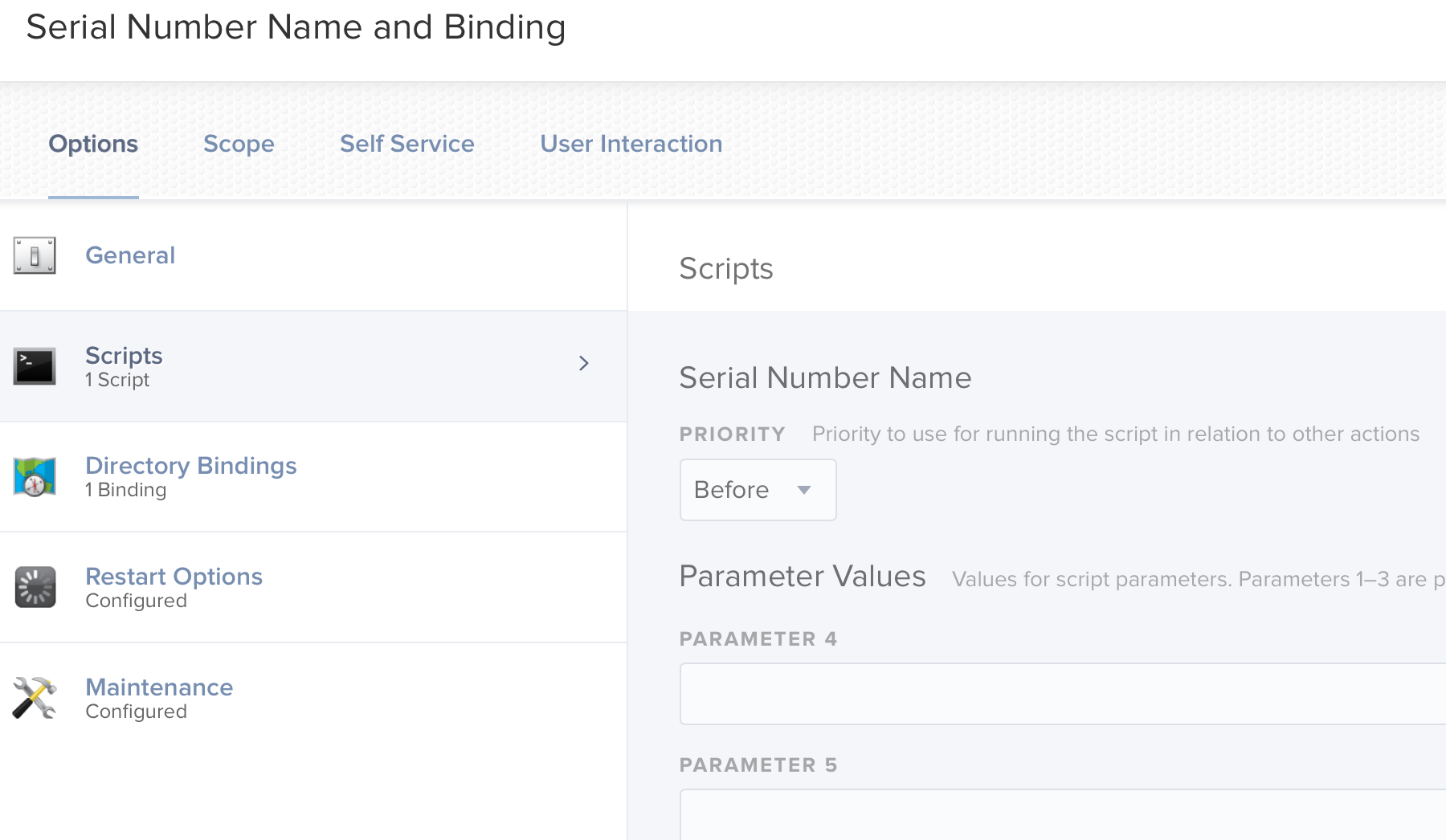

I tested this by creating a policy and it was successful.
1) I added the name change script to run BEFORE 2) I added the Directory Binding that I setup in Computer Management
SUCCESS!
However, is this the route to go? Is the Directory Binding setting in Computer Management more of a legacy feature?

I've made progress, thanks to the people who have chimed in on this post. I ended up creating ONE policy with three components to it, but it's still not ALL the way there yet.
First component of the policy is to add a script payload. I selected the name change script I wrote that changes the name of the Mac in three places to the serial number. I chose to run the script's priority to run BEFORE any other actions within the policy.
Second, I added a Directory Binding payload to the policy. You have to configure a directory binding in Settings>Computer Management then you can add it to the policy.
Lastly, I added an Update Inventory to the Maintenance payload.

@ edullum Here is a screen shot of the settings in Jamf Pro:
Here is the script we use to set the computer name of the laptops to the serial number:
