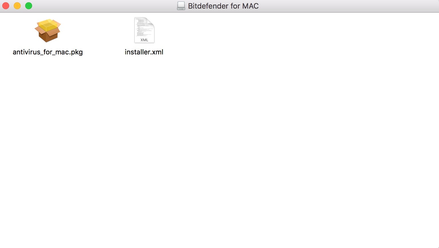

We're also using it for our fleet of Macbooks. It's ok, the Cloud console takes a bit of time to get accustomed to. Currently have an odd problem of some computers unmanaged by BitDefender's Cloud Console. BitDefender Support examined logs of affected computers and stated the PKG file needs to be in the same directory as installer.xml.
Anyone have any advice on which Composer method should be used to create this package.
Forum|alt.badge.img+23

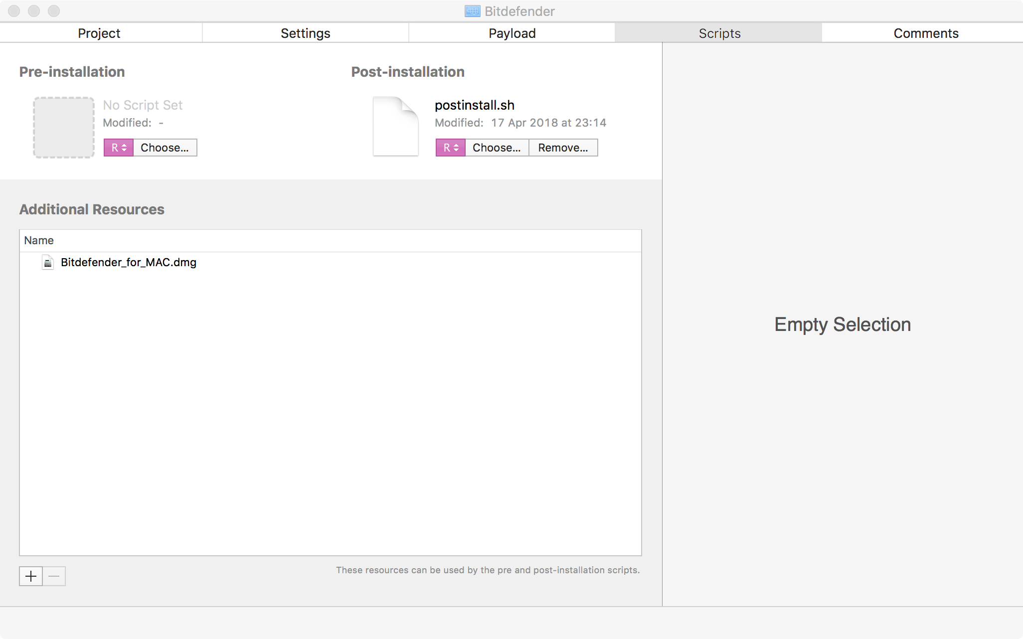

  • April 18, 2018
You don't use Composer. I use Packages, put the entire dmg into a project with a postinstall script that I reworked from @rtrouton .
# Determine working directory
install_dir=`dirname $0`
# Specify location of the Junos Pulse disk image
diskimage=$install_dir/"Bitdefender_for_MAC.dmg"
# Specify a /tmp/junospulse.XXXX mountpoint for the disk image
tmpmount=`/usr/bin/mktemp -d /private/tmp/bitdefender.XXXX`
# Mount the disk image to the /tmp mountpoint
hdiutil attach "$diskimage" -mountpoint "$tmpmount" -nobrowse -noverify -noautoopen
# Install Bitdefender
/usr/sbin/installer -dumplog -verbose -pkg "$(/usr/bin/find $tmpmount -maxdepth 1 ( -iname *.pkg -o -iname *.mpkg ))" -target "$3"
# Unmount the disk image
/usr/bin/hdiutil detach "$tmpmount"
# Remove the /tmp mountpoint
/bin/rm -rf "$tmpmount"
exit~[upload](d89cb861151043599020941bd13b060a)

@ProFX So the directions seem a little sketchy.
  • "Click Scripts and configure the Files and Processes payload. Enter the following Execute Command: installer –pkg /Users/Shared/antivirus_for_mac.pkg –target /" * This part doesn't make any sense and the screenshot doesn't match. Is this a script or is this an execute command?
KyleEricson
  • November 28, 2018
@franton Can you share more details with your project in packages. I was able to create a package, but the GUI said there was a error and I'm afraid that JAMF will not like that. The software seems to have installed find though.
  • November 28, 2018
@kericson Yeah, that part of the instructions were a bit wonky. I used the "Execute Command" field under "Files and Processes". Also, the command I used was this:
/usr/sbin/installer -pkg "/Library/Application Support/Bitdefender/antivirus_for_mac.pkg" -target /
I was having issues with the original command shown in the instructions on the Bitdefender site and JAMF support had me modify it to the above. Note that I changed the location of the installer file as well.
