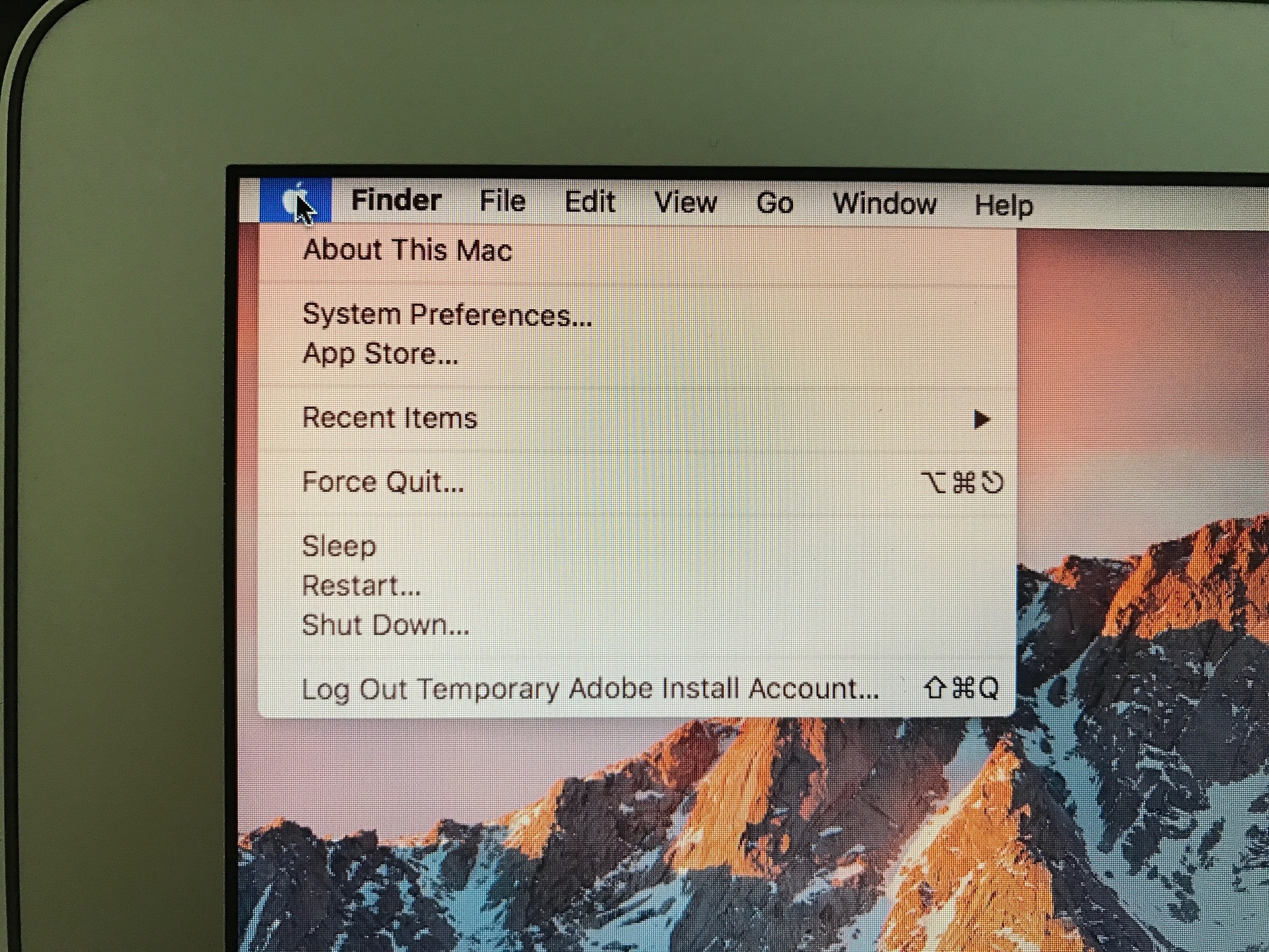

We are having with 10.11.x Casper Imaging. Our problem is that after the OS installs and restarts to install additional software, the machine boots to the Temp Adobe Admin account and remains on the desktop until the installation is complete.
I have a ticket open with JAMF Support, but so far we haven't been able to establish a root cause. The problem follows to all El Cap versions, no matter how it is imaged, regardless if it is Netboot or target disk mode. Even just the installer from the Apple store with a just a single software pkg will produce the problem. We running 9.91.
Is anyone else having this problem? Any help would be appreciated. Thanks!!

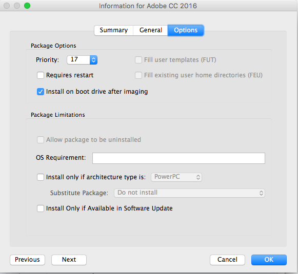

I had this same issue too, except when my machines booted to this temp account, it would sit there until rebooted. Then when rebooted, it would auto log back into the temp account only to sit without doing anything. To resolve I set my adobe installer to install after the first boot and set it a high number priority.
  • Jul 25, 2016 5:35 PM UTC

@lisamcray look for the checkbox that is in @psd_martinb's screenshot.
The name "adobeinstall" is an old name, but doesn't mean any Adobe software is being installed.
Just an item with that checkbox.

@lisamcray any software you have the "Install on boot drive after imaging" option checked will get installed at first boot in a temporary account called adobeinstall. This is normal. The account is created and deleted as part of the installation process. If you don't have any software with that option checked then you won't likely see the adobeinstall account at all. The name JAMF has chosen for that account is a bit confusing. I wish they would call it something else to avoid any confusion.

I think maybe that my post wasn't very well worded. I understand that the Temp Adobe Admin account is being used as the administrator account under which software is installed after laying down the OS.
My issue is that I'm seeing a desktop, and I shouldn't be.

Brief update on the Temporary Adobe Install Account topic: after creating [1] a Sierra (10.12.1) base image with AutoDMG and [2] an admin account package with CreateUsePkg, we used Casper Imaging to install the OS and, after imaging was complete, add the admin account.
Upon booting, the computer automatically logs in to the "Temporary Adobe Install Account," as others have reported.
After the first run scripts complete, the computer reboots, the normal login screen appears and the temporary adobe install account is gone

I have created the Payload free package and set it up as instructed. Made sure everything else is a later order for install including Adobe which I moved way down the list and I'm still getting this Temp User Account. And this is a Sierra install.

I am having the same problem with Sierra, was wondering if it was just me or not. 10.12.3 for my base OS. Using JSS 9.97.1482356336. Have about a dozen packages deploying after the first reboot. It logs into the account, seems to run all the installs correctly and reboots. Only thing missing is the Jamf helper window.
EDIT: Moving Adobe Creative Cloud and Office 2016 to a higher numeric priority resolved my issue. I had everything at 10-12. Spaced them out and put the largest packages at the end and that seemed to fix it.
