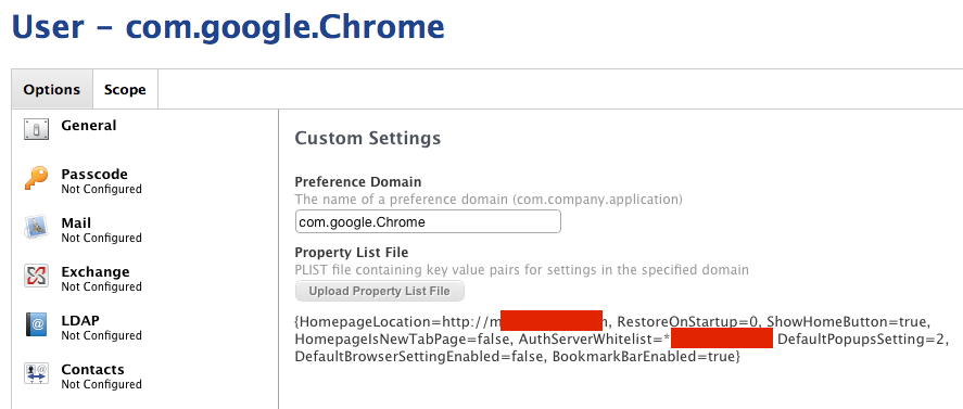

@dajackson Nowadays, I do this via a custom setting Config Profile.
You could write a plist out with the defaults commands above, & then upload to the JSS to create the profile.
They will then stick.
