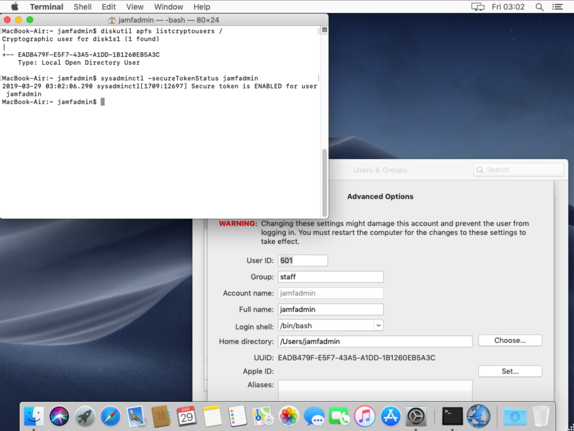

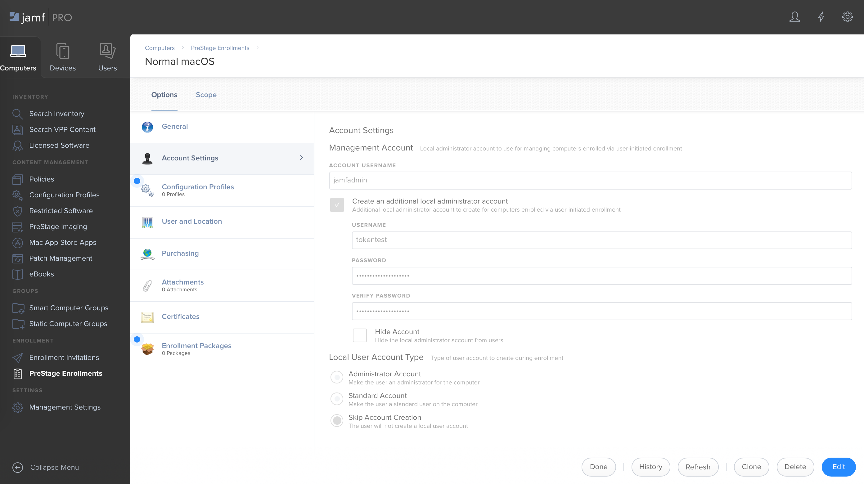

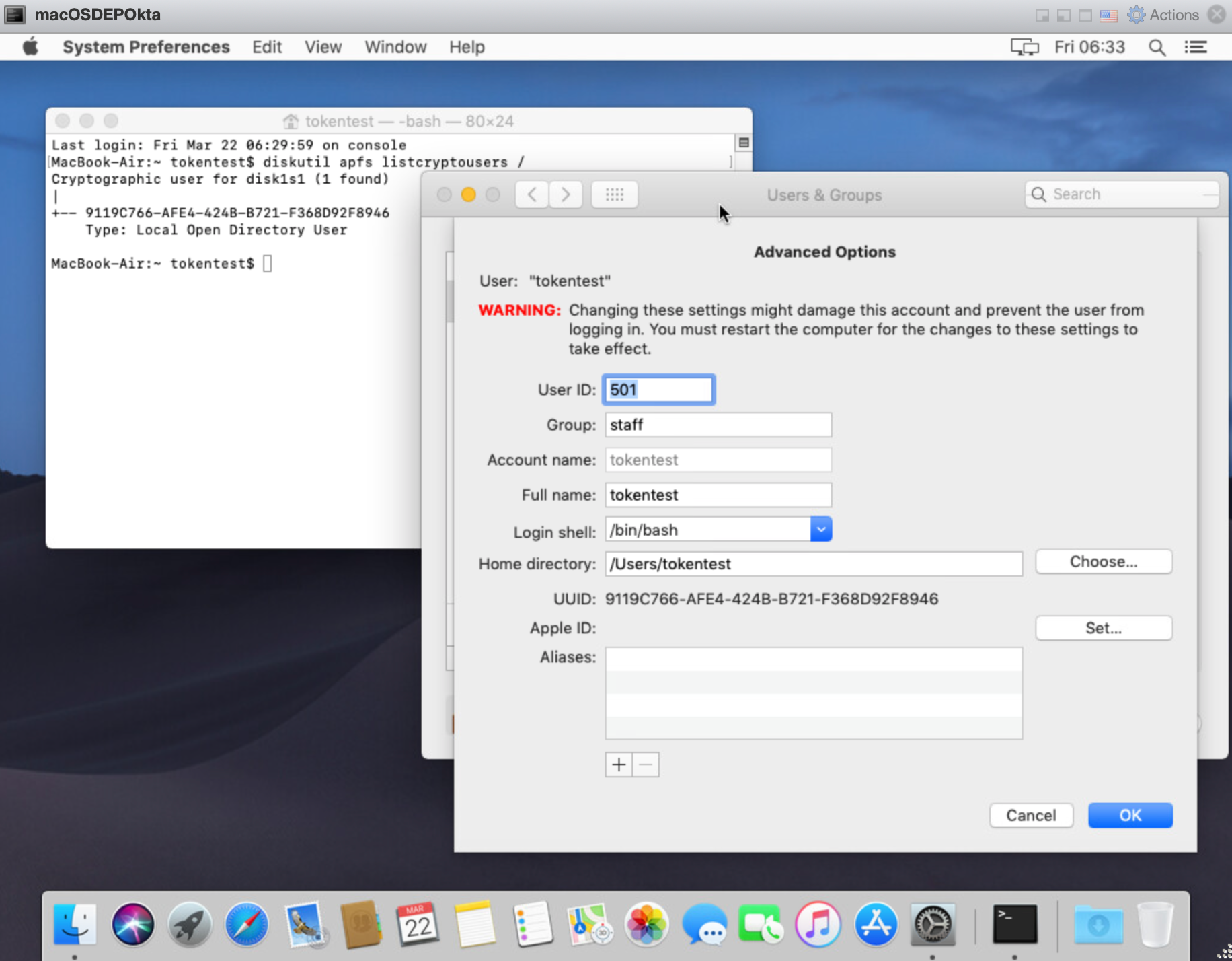

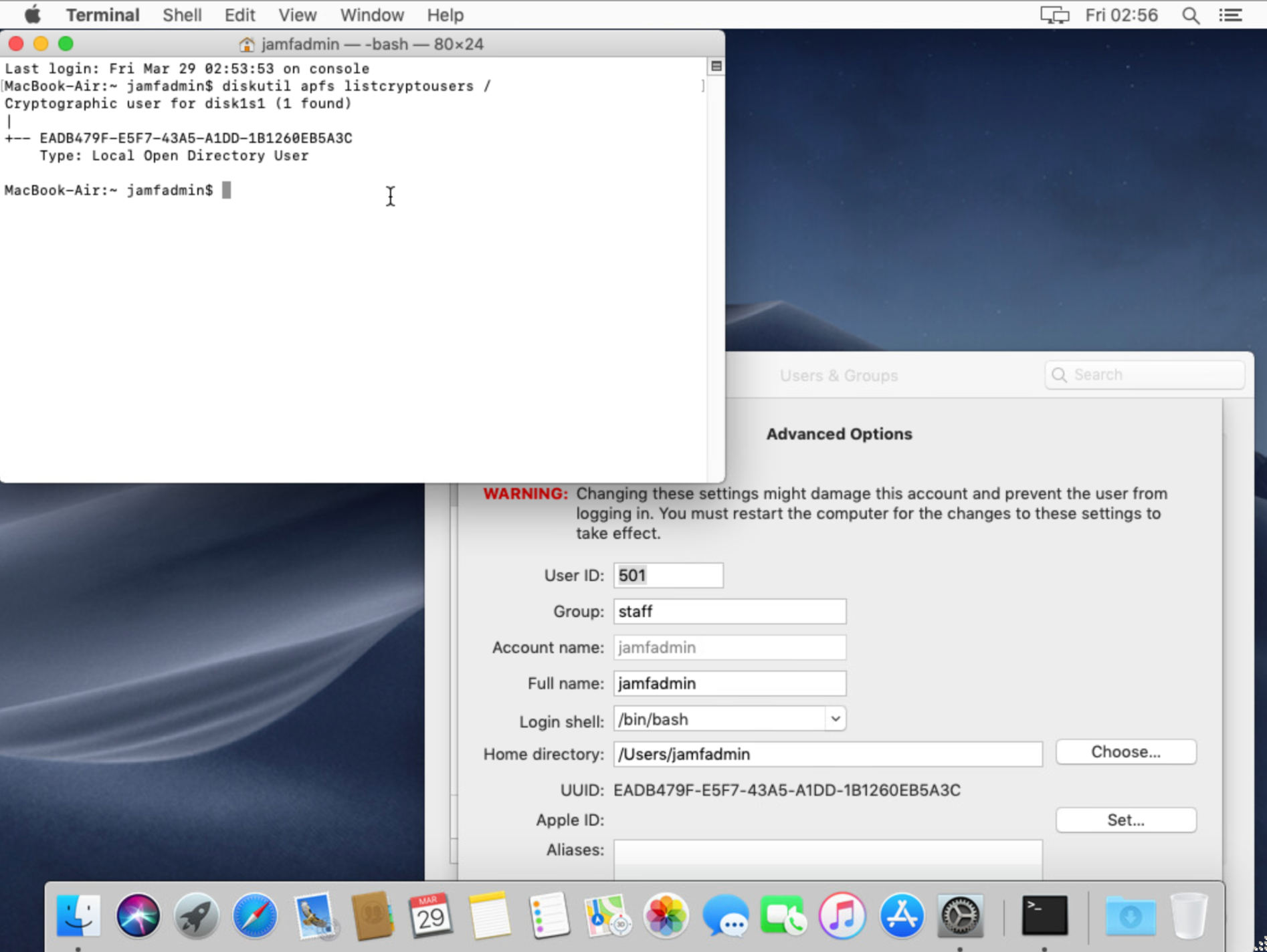

@ebonweaver I just tested again, although I was 100% sure about my statement.
So I created a new prestage, skipped the account creation, and created an additional admin user. I log in with this user as the very first user ever logging in to the Mac... and it DOES get a secure token..

:-) no sir, I did not and I would not know why I would do that. I can replicate exactly the same scenario on physical machines.
Clean Mac (VM or Physical) -> Jamf Pro prestage -> DEP -> NO other user logs in -> the additional admin or the Jamf management account logs in as very first users: it gets a token.
If that is not working for you, there must be something your are doing in between the steps above to break it. It's as simple as that. The first LOCAL admin account logging in to a CLEAN Mac gets a secure token.

@ebonweaver No, the version of Jamf does not impact anything regarding secure tokens. The only variable playing a role is the first user logging in.
First user ever logging in to the Mac = local admin = gets a secure token
First user ever logging in to the Mac = local standard = no secure token
First user ever logging in to the Mac = mobile account = no secure token
That said, having NO secure token holder at all is NOT a problem. Just enable Filevault with policy or profile, and the user actually enabling it (at logout for profile, at login for policy) WILL get a token. Whatever account type it is.
Jamf Pro version compatibility with Mojave security features, is completely irrelevant. That's for KEXT and PPPC.
It's really as simple as it is: if the first user is a local admin, whether that is the management account created by Jamf, or the additional admin account you create in the prestige, or a local admin account created by the end user in the setup assistant does NOT matter.
MacOS doesn't know anything like "a Management account". There is no such thing. macOS only knows admin or standard. How it was created does NOT matter. Again, if the very first user logging in is a local admin, it gets a token.
The "management account" created by Jamf is only a local admin, nothing special about it, no difference with any other local admin. The only reason Jamf calls it "management accounts" is because, if created by Jamf Pro, Jamf Pro knows the password (encrypted in the Jamf Pro Database). This either "a known password" or a Randomly Generated password (see User Initiated Enrollment Settings in Jamf Pro).
The only purpose of that "Management account" is to use Jamf Remote... as Jamf Pro knows the password, even if randomly generated... it can just remote into the Mac. No other purpose at all, NO impact on Secure Tokens or whatsoever.
Again, I'm sorry to repeat it: it's only the first ever user logging in impacting your Secure Token situation.
Just to be sure, with logging in I mean physically logging in... not remoting in via ssh or so...

@ebonweaver well, I'm only trying to help, and I can only say I'm deploying Jamf on a daily basis. Yes, I'm positive about the following statements:
  • I have no reason not to believe you. Just trying to help.
  • Jamf Pro on it own does not have any influence on whether the first local admin account logging in, before ANY other user ever logs in, gets a token or not. It just does.
  • It does not matter if it's the "management account", the extra DEP Prestage admin account, or the admin account created by the end user during the setup assistant. First user logging in = local admin = token
This taking into account:
- we are talking about macOS 10.14.2 or later
- we are talking about CLEAN macOS deployments, wiped devices going through a clean DEP workflow
- there are no @enrolment triggered policies with scripts or things happening which might break things. I would not immediately know what could break it, but I just be sure, you tested with a prestage, skipping account creation and logging in with the additional account without anything else. Obviously you would be deploying things post enrolment etc... but just to make sure you tested the exact same basic scenario. From there you would be able to isolate potential reasons for trouble
Just too show you I'm not inventing anything, doing some trickery, I hereby give you a screen recording. Yes, it's a VM, but I have no reason to lie about it, it's exactly the same on my physical machine. Just in case... I added the running clock to the screen to show I'm not editing the video. Its a bit slow... it's running on an old virtualised Mac Mini, but yet again, same result on physical device.
VIDEO
Hope you find the reason for the trouble.

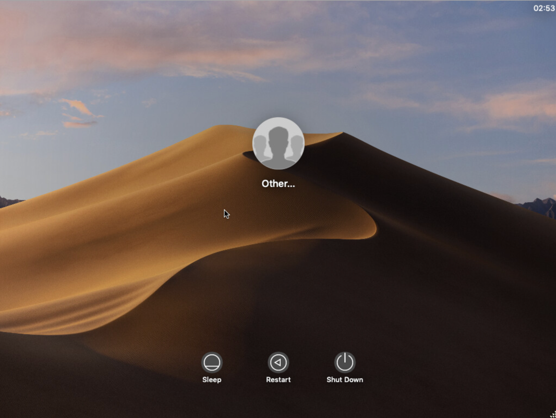

Hi @applesupport I just tested on macOS 10.14.3 (I need to update my vFuse VM for 10.14.4 but I would really be surprised if that would change anything, but I'll test again later).
I have a clean macOS, going through the pre-stage with "skip user creation". The only account being created is the "Management Account", which is set to be hidden in "User Initiated Enrolment" settings in Jamf Pro.
After the setup assistant I can confirm the account is hidden:
I log in with the Management Account and I DO have a Secure Token, while FileVault is NOT yet enabled:
