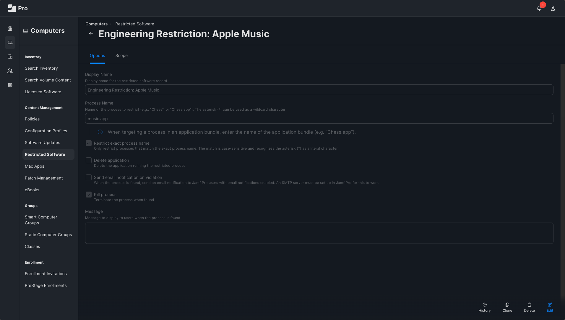

The best you are going to get without a proper application whitelisting tool, is using Jamf Pro's Application Black Listing (Software Restrictions). You should be able to configure the restriction to target music.app, and tell it to kill the process when seen. Once the Restriction is in place, and the jamf framework updates the app will close almost instantly when someone tries to open it.
App Restrictions use the Jamf Framework, and the Framework must update for any new restrictions to work.
It should look something like this.

You can't delete the Music.app as it's protected by SIP, so it would involve booting to Recovery, disabling SIP, rebooting into the OS, removing the application, then rebooting back to Recovery to enable SIP. Too much complication, not to mention that can't be automated in any way.
Restricted Software should allow you to restrict use of the application so it won't launch, or at least will get quit a moment after it's opened. If it's taking up to 1 minute to take effect, then either something is wrong with the setup, or as suggested above, the Jamf framework took some time to update on the device and that's what you witnessed.
Have just found this thread as trying to restrict music, where you mention about the framework needing to update is this automated, new to Jamf and have setup the software restriction but music is still opening and staying open.
Thanks
  • Jan 9, 2026 10:15 PM UTC
