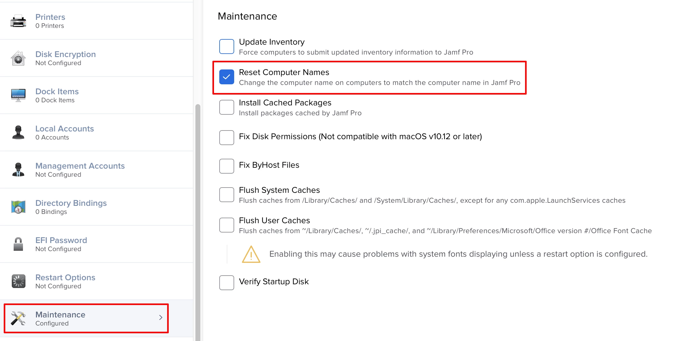

  • May 18, 2021
We use a maintenance policy to reset computer names (once a day):

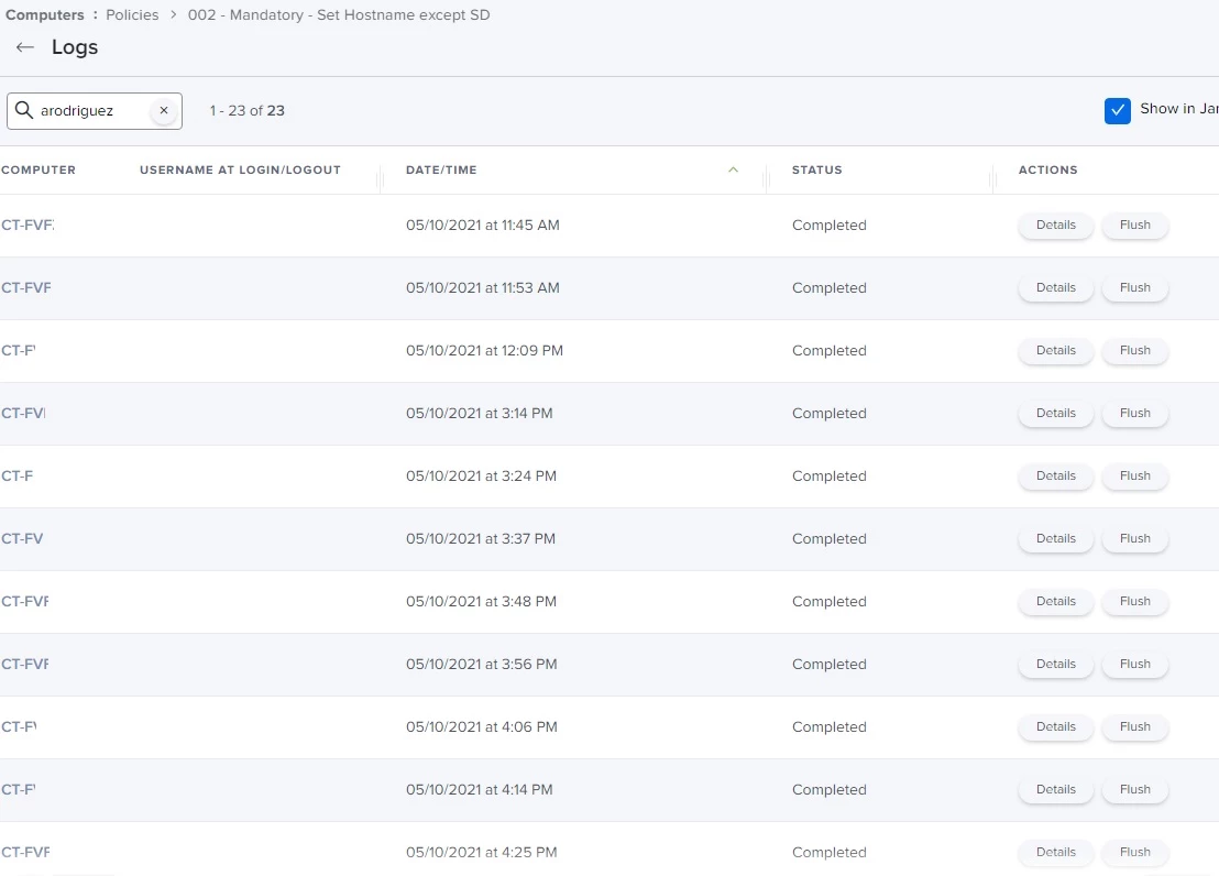

I have kept my Mac hostname script in ongoing state, where during every policy refresh(5 mins interval), it will check the name and rename it as per script. Even if user intentionally changes the name or software enforced the name change, it will revert it to as per the script. As per our script, hostname will be user's local initial-serial no. User location is being picked up through azure query and stored in jamf. Even you can local cache the script. This doesn't slowdown the mac at all.
