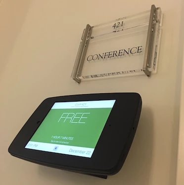

Is there a hardware adapter/splitter solution out there that will provide Lightning to USB and also provide a second Lightning port for A/C power, too?
I manage a lot of wall-mounted iPad conference room kiosks (running Roomr). Wi-Fi is fairly flakey here due to lots of concrete as well as interference from scientific equipment.

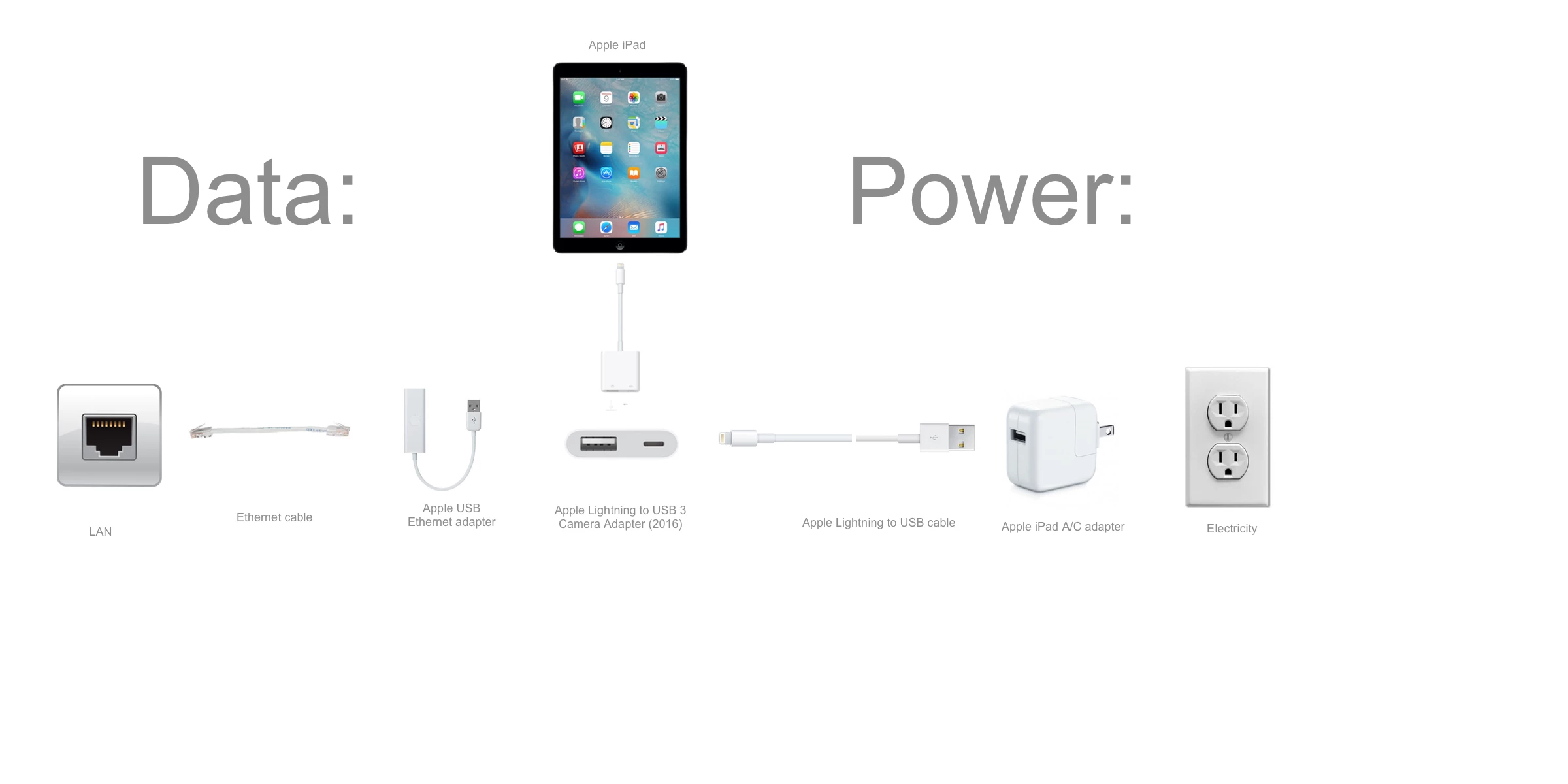

  • March 25, 2016
Apple released a new Lightning to USB 3 adapter in March 2016. It provides both USB data and A/C power in a single Y-style adapter. No USB hubs or thrid-party drivers/frameworks.
Bye-bye, Wi-Fi.
I'm so excited that I made a pretty diagram.

  • April 6, 2016
Yes, I have 10 iPad mini 2 (Retina) running both iOS 9.2.1 and 9.3. They are used as conference room kiosks running Roomr. All of them work great in the configuration that I illustrated above.
My biggest complaint is iOS doesn't reflect the lightning Ethernet interface in the iOS GUI (that I am aware of), so you can't see relevant IP information, etc.

  • April 12, 2016
@dstranathan (or anyone for that matter), what cases/mounts are you using? I can't currently hide all those dongles in the wall so I need a mount that will neatly hide them.

  • April 12, 2016
Wall Mounts:
Wedge Tablet Wall Mount
Link: http://armoractive.com
Weight 1 lbs
Length 2.75 in
Width 4.75 in
Height 5.50 in
Color: Black
Note: Drill (4) 5/16" holes for wall mounting.

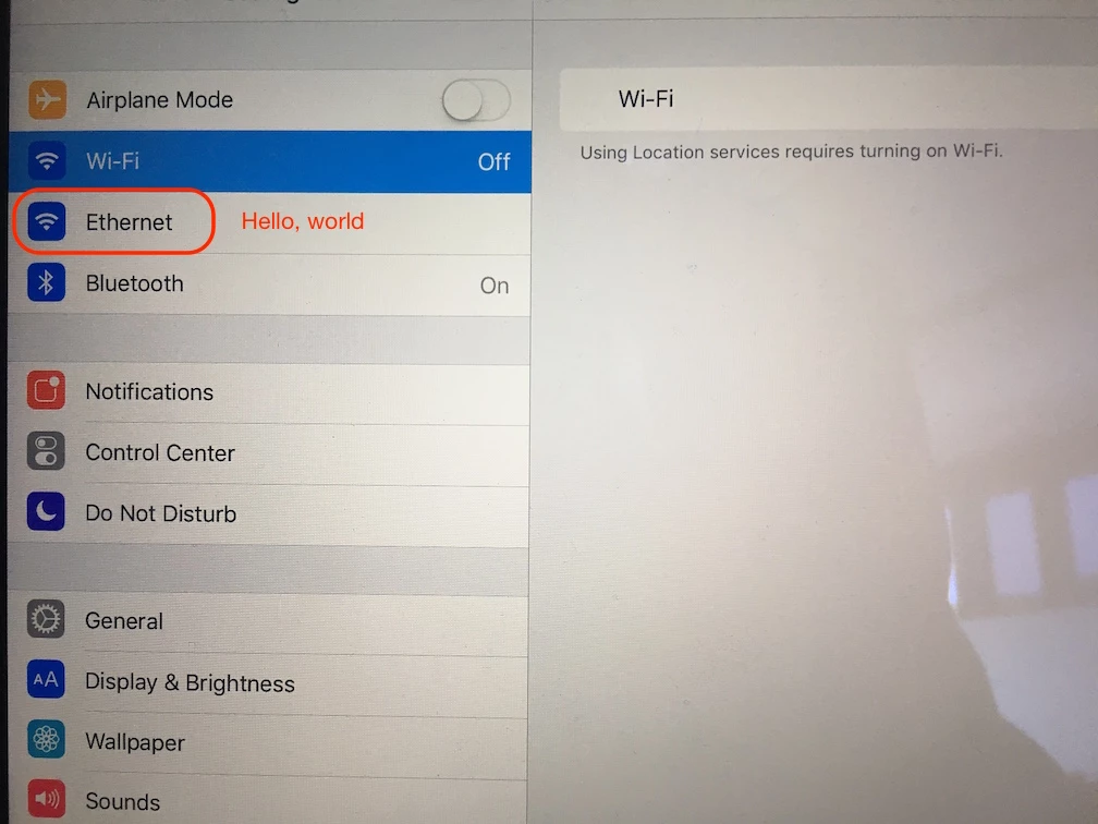

  • June 17, 2016
News flash: iOS 10 (beta 1) now shows Ethernet/Lightning interfaces in the Settings app.
The Ethernet pane itself is blank (at least on my test iPad Pro 2), but this is certainly good news for IT going forward..
Ethernet in 'da house, yo.
