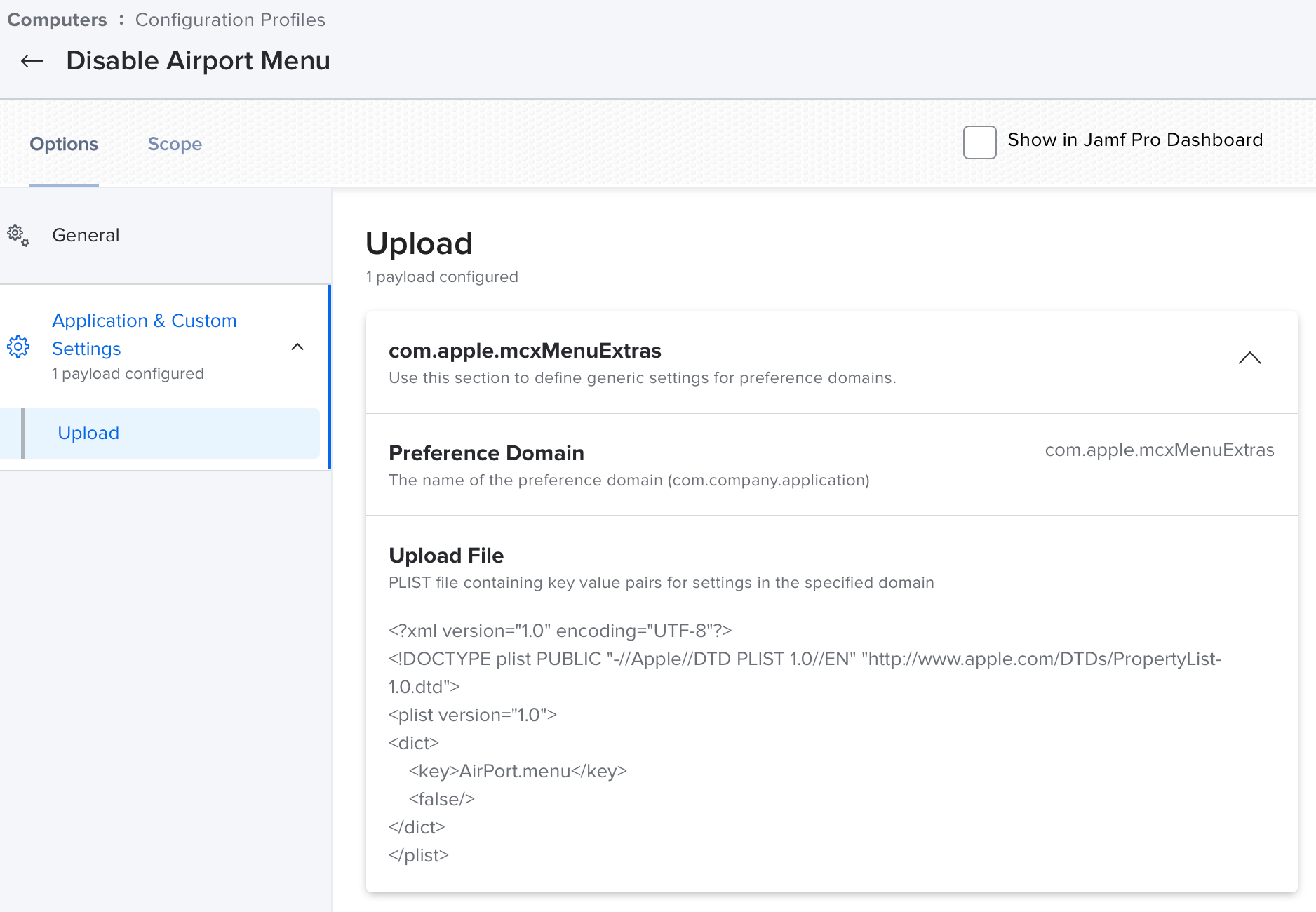

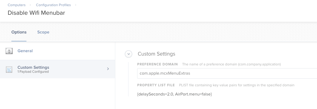

Hi @echalupka,
we placed it in Computers -> Configuration Profiles, where it's defined as a Custom Payload.
The end result looks like this:

This worked for me.
