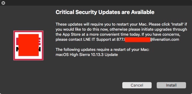

We are waiting on approval for a policy that checks available critical software updates and splashes a jamfhelper dialog box up to the end user. If the employee clicks "Cancel" it executes again the next day. If they cancel too many times, it executes on the hour until they comply.
If the update requires a reboot, once the employee clicks "Install" they will get a second dialog box urging them not to reboot their computer until that dialog box quits.

decide_updates() {
local current_user=$1
model_id=$(sysctl hw.model | awk -F'MacBookPro|,' '{print $2}')
# if there is no one logged in, just run the updates
if [[ "$current_user" == "" ]]; then
$UPDATE_TRIGGER
# Software updates have finally run, remove computer from scope to prevent repitition
remove_from_scope
rm "$RUNINDEX"
shutdown -r now
else
# Someone is logged in. prompt if any updates require a restart
if [[ "$RESTART_REQUIRED" != "" ]]; then
# Preconfigure message to end user for dialog box
# If this is a TouchBar Mac, warn user that update will take longer
if [[ $model_id -gt 12 ]]; then
description_text="These updates will require you to restart your Mac and could take 30 minutes. Please click 'Install' if you would like to do this now. If you have concerns, please contact $CONTACT_INFO"
else
description_text="These updates will require you to restart your Mac. Please
# Execute jamfhelper dialog box, and collect result to variable
install_choice=$("$JAMFHELPER_PATH" -windowType hud -icon "$ICON_PATH" -heading "Critical Security Updates are Available" -description "$description_text
The following updates require a restart of your Mac:
$RESTART_REQUIRED" -button1 "Install" -button2 "Cancel" -cancelButton "2" -defaultButton 2)
if [[ "$install_choice" == "0" ]]; then
# Restart is required, so throw up another dialog box telling user that
# the dialog box will disappear when updates are staged/complete, and
# they should reboot the computer at that time.
run_updates
else
exit 1
else
$UPDATE_TRIGGER
remove_from_scope
rm "$RUNINDEX"

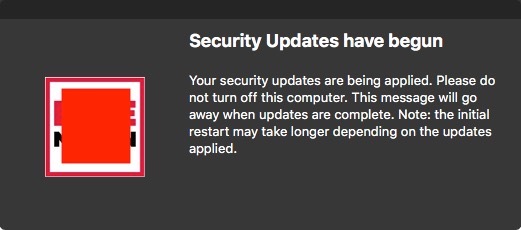

run_updates() {
"$JAMFHELPER_PATH" -windowType hud -lockHUD -heading "Security Updates have begun" -description "Your security updates are being applied. Please do not turn off this computer until this dialog box disappears. This message will go away when updates are complete. Note: the initial restart may take longer depending on the updates applied." -icon "$ICON_PATH" > /dev/null 2>&1 &
# We'll need the pid of jamfHelper to kill it once the updates are complete
jamf_helper_PID=$(echo "$!")
$UPDATE_TRIGGER &
# Get the Process ID of the last command run in the background ($!)
# and wait for it to complete (wait)
softw_upd_PID=$(echo "$!")
wait $softw_upd_PID
# Kill the jamfHelper. If a restart is needed, the user will be prompted.
# If not the hud will just go away
kill -s KILL $jamf_helper_PID
remove_from_scope
rm "$RUNINDEX"
