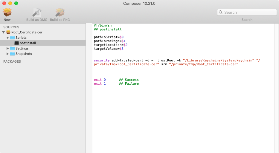

Can you not package it and have a post install script that installs it with trust settings?
Rich Trouton has a blog post here on how to add a cert to the System keychain with trust settings
The primary command is:
security add-trusted-cert -d -r trustRoot -k "/Library/Keychains/System.keychain" "/private/tmp/certs/certname.cer" srm "/private/tmp/certs/certname.cer"

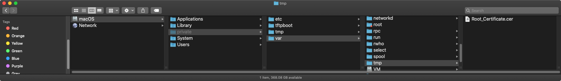

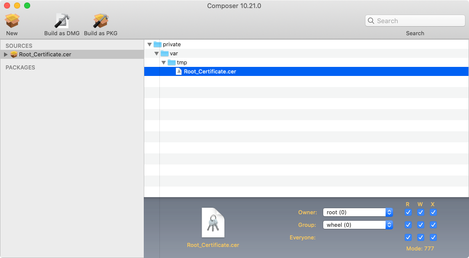

Copy the certificate to /private/var/tmp
Drop it into Composer
Check the permissions are appropriate

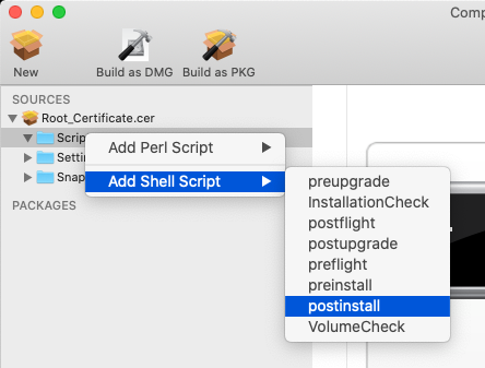

Expand the name of the package in the left hand column so the 'scripts' folder shows
Right click and 'add shell script' > postinstall
Add the previous shell command to the script, adapted to point at the certificate
Build as PKG
Add to policy so it gets delivered to all the machines scoped

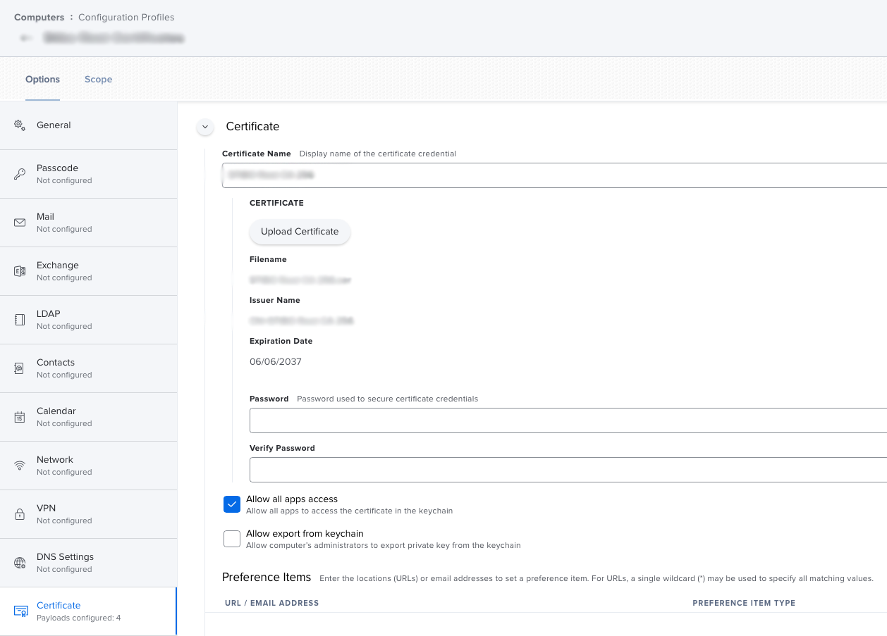

You pretty much have to use configuration profiles pushed by MDM on Big Sur. We switched to that and it's working well.

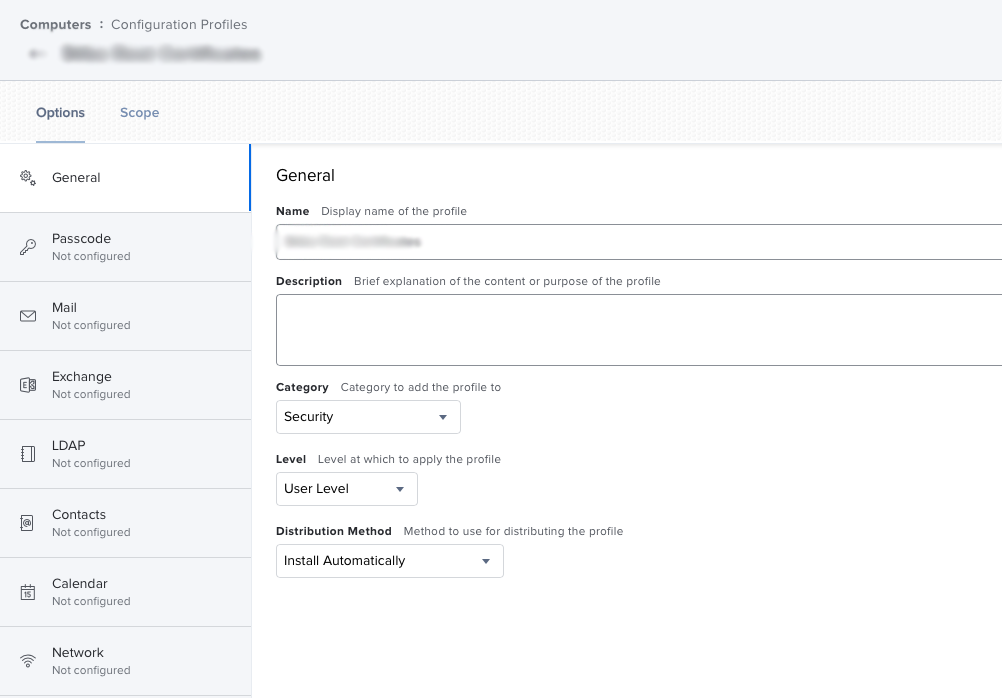

We're using the following configuration profile to install four certificates on Big Sur. The root certificate in the screenshot get's set to "Always Trust" for all purposes but two intermediate certificates issued by the root certificate plus a fourth don't. They get set to "Use System Defaults" which means that users still may get prompts to trust the certificates. Unfortunately I don't know enough about certificate chains to explain or rectify this so I'll manually trust these when configuring a new computer.

so just for a sanity check, when pushing a cert from a config profile, checking the Allow all apps access box is the same  as going into keychain and changing the trust from default to always trust??
  • Jan 12, 2022 6:26 PM UTC
Not from my experience, no.
