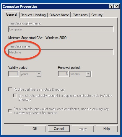

@ianmb we use the same cert for our Macs & PC's via ADCS.
The thing to make sure of is that the in the request profile payload, use the cert templates name & not display name.

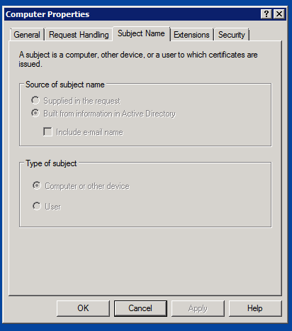

@bentoms Thanks. Can I just confirm that your template only has the Service Principal Name (SPN) option checked, and nothing else?
bentoms
Forum|alt.badge.img+35
  • Aug 24, 2015 9:54 AM UTC
@ianmb you mean this?
  • Aug 26, 2015 2:38 PM UTC
@bentoms Actually ours looks slightly different (we use Windows Server 2008 R2?), and we have 'DNS Name' checked rather than SPN as I suggested earlier...
