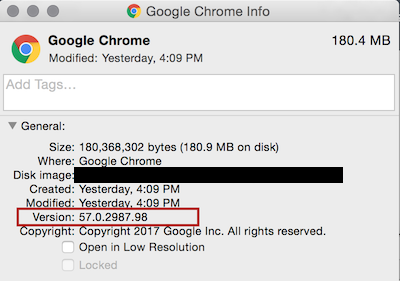

  • March 9, 2017
LOL! No sooner did I post the above and Google released an update. Didn't need to wait long! The code above (and I assume your python EA as well) is working to show the new version, 57.0.2987.98, which means those pages get updated simultaneously along with new releases. Wow! Impressive!

@mm2270 just noticed the update too! Most of my Macs have already picked up the update because of the script, which is great!

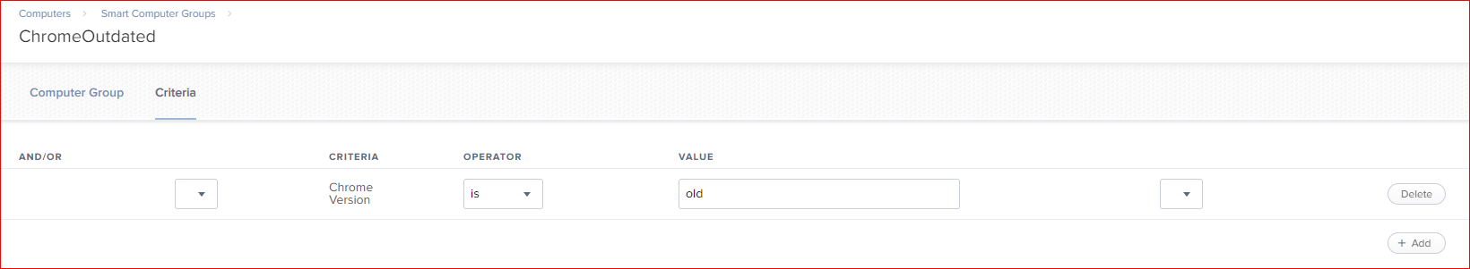

@LewisLebentz Not working for me, maybe missing a step or something. When Lewis says " I made a Smart Group targeting all Macs where Chrome Version = Old" how does that translate into the Smart Group, how do you create it.
Thanks
  • October 17, 2017
@LewisLebentz Any update on creating the Smart Group? This would be great to implement but I am in the position as @tld75000. How do you create a Smart Group with the Criteria of "Chrome = Old"? Any help would be appreciated. Thanks.

@JeffA you can do a smart group with the criteria "Chrome like old"

@JeffA You've probably figured this out already. For anyone who creates the Extension Attribute, you would create a Smart Group and there will be a "New Criteria" with whatever you named the EA. For example, I named mine Chrome Version, so I have a new criteria option called Chrome Version, then I just use the value is "old".
