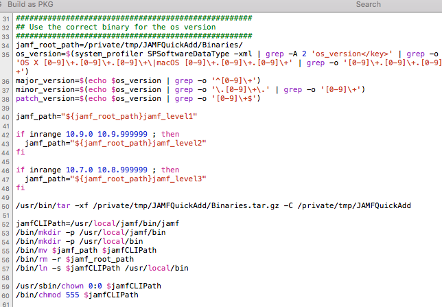

I was having problems with the new Quick Add package that I created after we updated to Jamf Pro 10.4. It seems that there is a bug in the Scripts>postinstall script.
I had to open the newly created Quickadd package in Composer
Scripts>postinstall scroll down to the "Use the correct binary for the os version," There is a command line missing - in my QuickAdd it is line 54. I have attached a screen shot /bin/mkdir -p /usr/local/bin
Once that command was entered, and the QuickAdd was saved, I was back in business.
I hope this helps others!

I should have indicated the symptoms of the problem
Unable to use jamf commands in terminal -- Jamf command not found
Jamf Remote indicated
Failed to symlink JAMF The file "jamf" couldn't be saved in the folder "bin".
Failed to symlink JAMFAgent The file "jamfAgent" couldn't be saved in the folder "bin".

This issue was noticed in our environment following upgrade to 10.4.1 exactly as noted above by the original poster. Systems were enrolling correctly to Jamf PRO but had no access to utilize the Jamf binary afterward. All commands would fail. Upon comparing the newly generated QuickAdd package to our prior version QuickAdd package, we found that the mkdir command for /usr/local/bin was simply not present in the default postflight script included in the QuickAdd package by Recon 10.4.1. Adding that single line into the script resolved the issue for us. Had to removeFramework and delete the botched symlink on test units in order to get a clean test with the new, modified package. The resulting QuickAdd has worked for us consistently and provided a Jamf binary that is correctly accessible and functional for the end-user. Great catch @KAD! Thank you for posting your experience. You pointed us to exactly the right spot to quickly resolve this.
