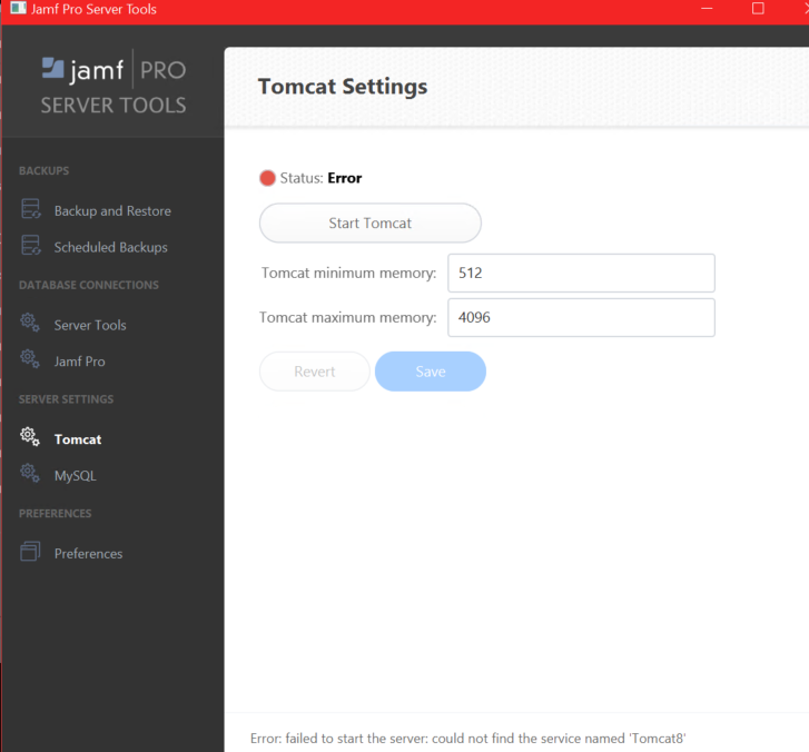

Is anyone else's Tomcat settings in Jamf Pro Server Tools broken after upgrading to 11.3 on On-Prem Windows Server?
Webserver is running just fine but Jamf Pro Server Tools show it as "not running" and throwing an error when trying to start it.

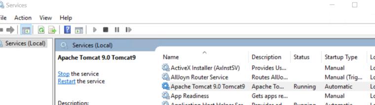

Can control Tomcat through net start/stop tomcat9 or the tomcat9w.exe without any issue.
As per warning:
  • As a result of PI116512, new installations and upgrades using the installers will fail if Java 21 is installed. Mitigation: Uninstall Java 21 and reinstall Java 11, or manually install Jamf Pro.
we stayed on Java 11.
Just curious if this is something with our install or a general update issue?
Thanks!

I have the same I think. Just upgraded my Dev JAMF server (Windows) to 11.3.2 and it seems Apache Tomcat 9 is now the version yet under the server tools it is not starting as it says it cannot find tomcat8. The JAMF web interface is working fine though so looks like the Server Tools part is not getting the fact it now uses Tomcat 9.
Do JAMF have any solution for this as I use the Server Tools a lot and don't like seeing the RED Status: Error lol

Thanks, good to hear I am not the only one affected.
Interestingly I get another error message (error: failed to start the server: exit status 2), but this might be due to other language pack on the server? If I remember correctly exit status 2 also meant something like service not found so it's probably the same issue.
I opened a ticket with Jamf yesterday, but no progress yet.
