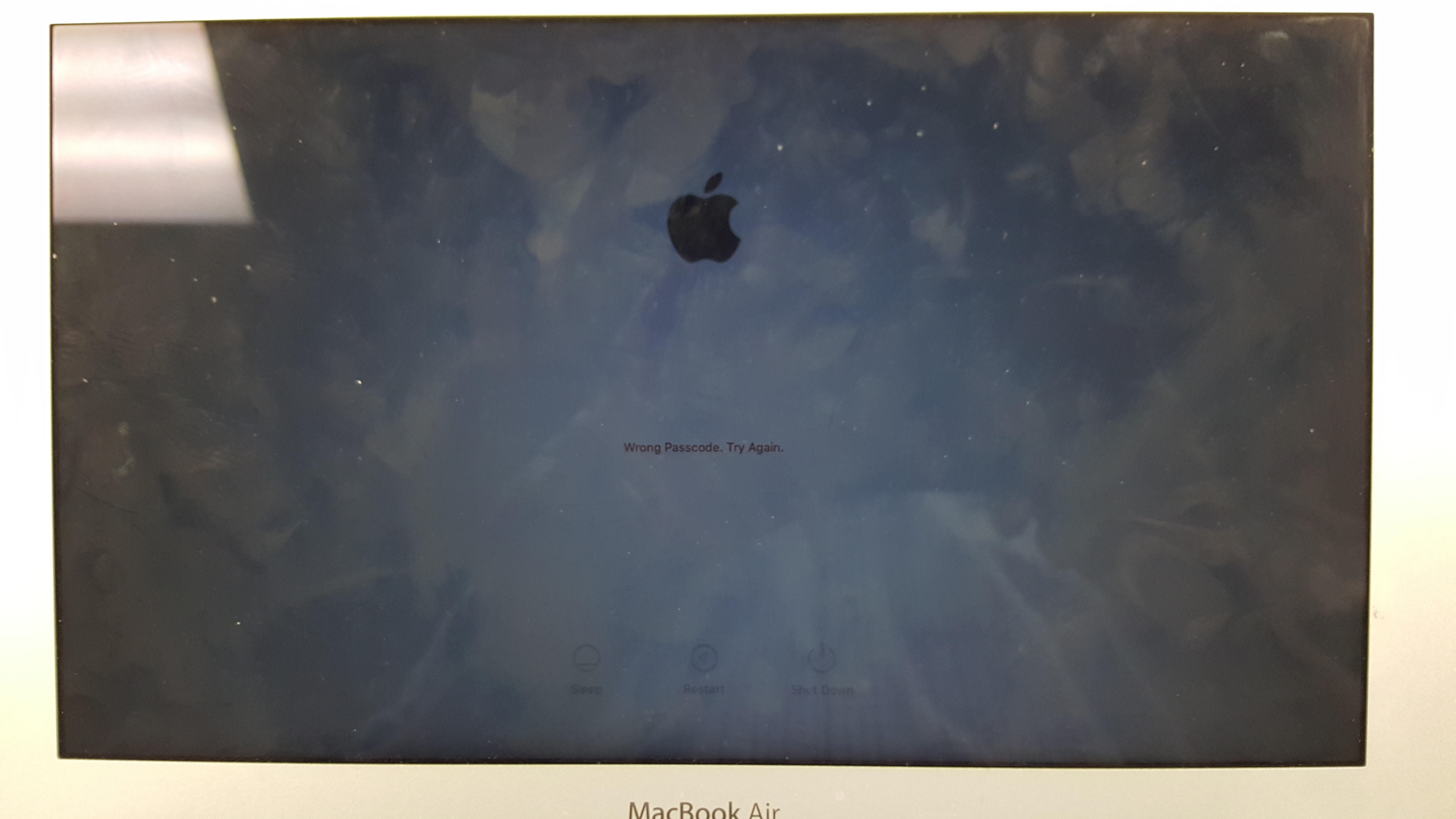

Has anyone been this stuck with a locked computer?
I locked a computer remotely using JSS and creating the 6 digit code. The computer successfully locked, the student then tried to guess what the code is and got it wrong. He then brought it to me with the screen displaying "Your computer is disabled. Try again in 60 minutes" Once that time runs out it just shows "Wrong passcode. Try Again" without ever giving me the option to enter a code. I have tried booting into recovery mode and doing an internet recovery. Both times it just boots to the same screen. I took it to the Apple store and they claimed they have never seen this screen before and could not help. I then spoke with my Casper rep. They had me do a PRAM reset and a SMC reset, both times it booted to the same screen. She then told me to call Apple Support and they had me try everything listed above again. Apple Care sent this issue to the engineers and I am waiting for a response.
I am looking for any suggestions to get this fixed.
Best answer by lpadmin
Just heard back from Apple:
They said that their is no coming back from this lock. It is a security feature that is made so if a thief enters the wrong code multiple times it turns into a paper weight. Since the computer can not tell if it has been returned to the rightful owner it just stays in this loop. Thanks for all of your input and help.
On a personal note I can't believe that Apple can't reset this lock screen when person can show proof that they rightfully own the computer.

@bpavlov Yes, the Apple genius at the store said the lock screen was not an Apple lock and did not know what to do with it. The AppleCare rep did not know what to do with the screen either. See attached for the screenshot of the lock screen after the timer runs out.

I was able to get the computer to boot into target disk mode. From there I plugged it into my computer and after 5 attempts Disk Utility was able to wipe the computer. Now when I boot it, I get the folder with ? flashing on the screen. I then tried using my OS X install flash drive and after selecting the drive it still goes to the lock screen. I then tried internet recovery and @jchurch suggestion and still getting the lock screen.
