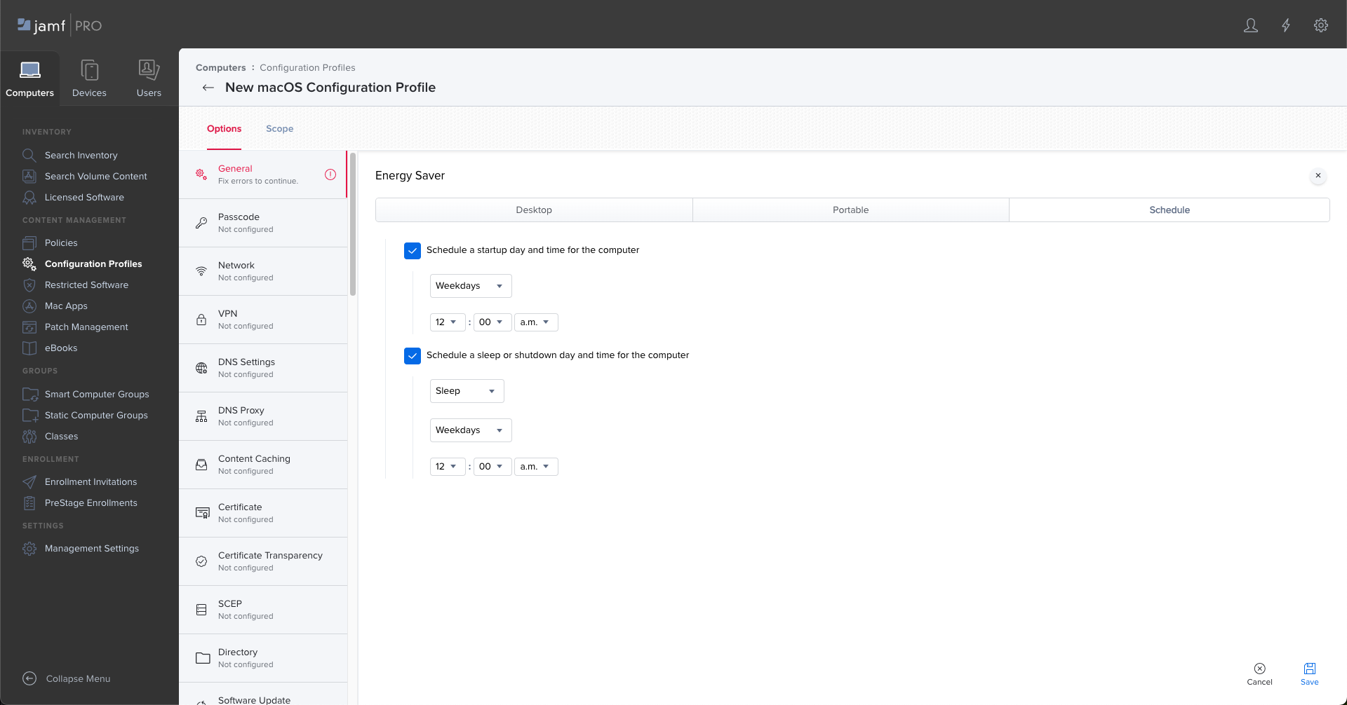

You can have your LaunchDaemon call a script, and within the script have admin creds (hopefully salted) to run the shutdown command. You can also adjust sudoers to allow shutdown to be run without admin access.
I would just use a configuration profile to turn off the Macs at a given time, and another one to turn them back on. For example shut the macs down at 9pm and turn them back on at 8am. The configuration profile is the "Apple Way" and most tamper resistant for sure as well as being easily backed off if needed.

To shutdown the machines at a given time is - from an energy saving perspective - not an option. There are ~50 Macs which are not shutdown ... every day.  This will sum up.
But thanks for your suggestions. Maybe a configuration profile will be an option if I don't find an other solution.
