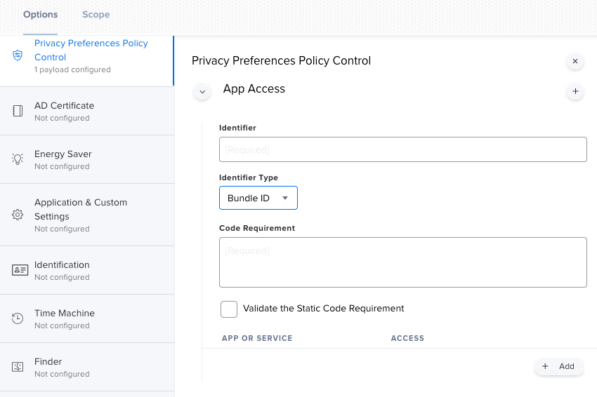

MikaelDez
  • Aug 10, 2020 8:23 PM UTC
@jtrant Forgive me because I'm pretty fresh to Jamf, could you explain where I need to whitelist that Team ID? I'm assuming under "Identifier" I would enter the path of the component and select "Path" under identifier type. We already have Mcafee's kernel extensions whitelisted in a separate profile. Also, what is required in the "Code Requirement" box? If I try and save this it highlights in red.
  • Aug 10, 2020 10:46 PM UTC
If you take a look at the bottom of the page you linked, McAfee have actually provided an example configuration profile, although they don't have the VShieldScanManager part for ENS 10.7.0 included. The code requirement is the same as VShieldTaskManager in their example profile but the code requirement would change slightly.

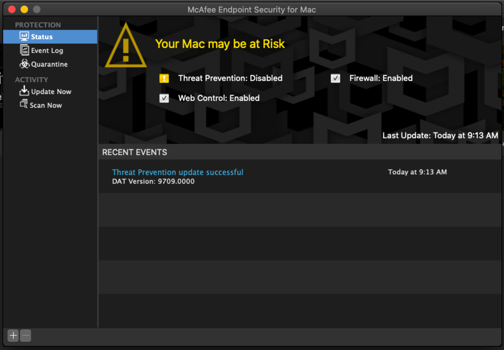

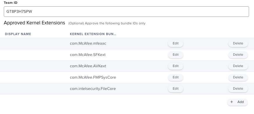

@jtrant I downloaded the example configuration profile and added VShieldTaskManager, I'm still getting that System Extension Blocked pop up, which I think might be causing McAfee to install without enabling Threat Prevention. Currently an end user would have to allow the extension in Security & Privacy and then enable Threat Prevention under McAfee's preferences. I have also whitelisted McAfee's kernel extensions, I've attached screenshots of the pop up and the kernel extensions I'm whitelisting in case there's something I'm missing.
  • Aug 11, 2020 2:25 PM UTC
Can you share the whole KEXT profile?
McAfee Team ID: GT8P3H7SPW
Bundle IDs:
ENS: com.intelsecurity.FileCore, com.McAfee.AVKext, com.McAfee.FileCore, com.McAfee.FMPSysCore, com.McAfee.mfeaac, com.McAfee.SFKext
DLP: com.McAfee.driver.DlpUSB, com.mcafee.DLPKext
I know with true system extensions they must be applied before the software in question is installed, but I didn't think this applied to kernel extensions.

This is the entire kext whitelist profile in Jamf Pro, it looks like I need to add some based off your list.
MikaelDez
  • Aug 11, 2020 5:45 PM UTC
I was able to get McAfee installed now with no security prompts with your kernel extension list, no PPPC profile involved. The only problem I have now is Threat Prevention is disabled by default, do you have any ideas on how to enable that, whether it be by script or anything else?
  • Aug 11, 2020 5:48 PM UTC
You'll still need a PPPC profile so that McAfee ENS/DLP can scan the machine (SystemPolicyAllFiles), but as for Threat Prevention being disabled I'm not sure. Do you have a valid license key entered in ePO, and do you have a policy in place to enable threat prevention?

There is a valid license key and I have restarted, the only thing I haven’t verified is if there’s a policy in place (I’m not the one person that manages ePO, and they insist that the default behavior of McAfee should have Threat Prevention enabled after installing, which is not the reality I’m experiencing)
  • Oct 8, 2020 3:16 PM UTC
I'm having the same problem that Threat Prevention is disabled, also after a restart. I have created a Kext profile for McAfee and also created a PPPC profile for the full disk access.
Hope someone has a solution for the Threat Prevention being disabled.

Are you able to enable it manually in McAfee's preferences?
Not sure if it's native to the application or something we control in ePO but our McAfee Threat Prevention will enable itself after a specified time if it get's disabled. Maybe that would be worth looking into if you can actually enable it manually in preferences.

@kgam Yes, it is possible to enable it manually but, as you know, you need to do this as an admin.
@Nix4Life That's the exact order I use to install McAfee
If you take a look at the following article from McAfee you can see that you will need 6 bundle identifiers. I've set all of them and also created a PPPC to give McAfee Full Disk acces:
End-user experience when installing Endpoint Security for Mac on macOS High Sierra 10.13 and later
But so far, no luck that it will automatically change from "Disabled" to "Enabled".
