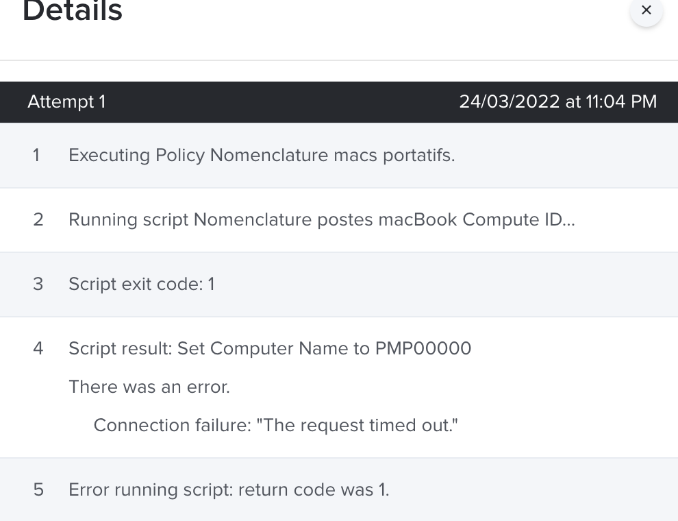

Hi @marcelp
This works just fine for 90% of our fleet. I have a remark though:
When client have network issue, the script assignt default name to machine locally & jamf: prefex + 00000!
jamf log error:
Can we add a script line to check client network before running ? any suggestion ?
Thanks in advance
  • Mar 29, 2022 6:45 AM UTC
I would make a smart group with:
Computer Name like prefix
And scope the policy with it. That way it reruns if it fails.

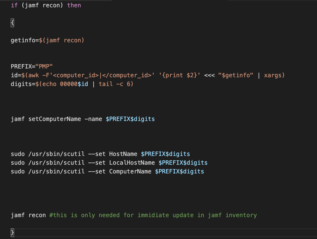

  • Apr 6, 2022 1:14 PM UTC
Hi @marcelp
I rather edit the script as shown. This works just fine. Thanks so much for you valuable help.

  • Apr 23, 2024 8:53 PM UTC
I fixed a few things with the script.
I moved the curly bracket ({)about the if statement and added a fi above the last jamf recon command.
This runs cleaner. Your PREFIX choice is your own.
I hope this helps.
if (jamf recon) then
getinfo=$(jamf recon)
PREFIX="MBP-"
id=$(awk -F '<computer_id>|</computer_id>' '{print $2}' <<< "$getinfo" | xargs)
digits=$(echo 00000$id | tail -c 6)
jamf setComputerName -name $PREFIX$digits
/usr/sbin/scutil --set HostName $PREFIX$digits
/usr/sbin/scutil --set LocalHostName $PREFIX$digits
/usr/sbin/scutil --set ComputerName $PREFIX$digits
jamf recon #Only needed to initiate immediate update in Jamf Inventory
