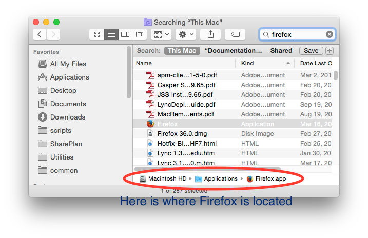

Open a new finder window.
In the upper right search box, type the name of the app.
Sort the columns based on "Kind", and scroll through to locate Applications.
Single click on the App name to highlight and reveal the location.
The path to the app is shown in the bottom of the Finder window.
In my example, I've searched for FireFox
Common places to look for Applications is within
/Users/myname/Applications
and within the work directory used by Composer
/Library/Application Support/JAMF/Composer/Sources/
