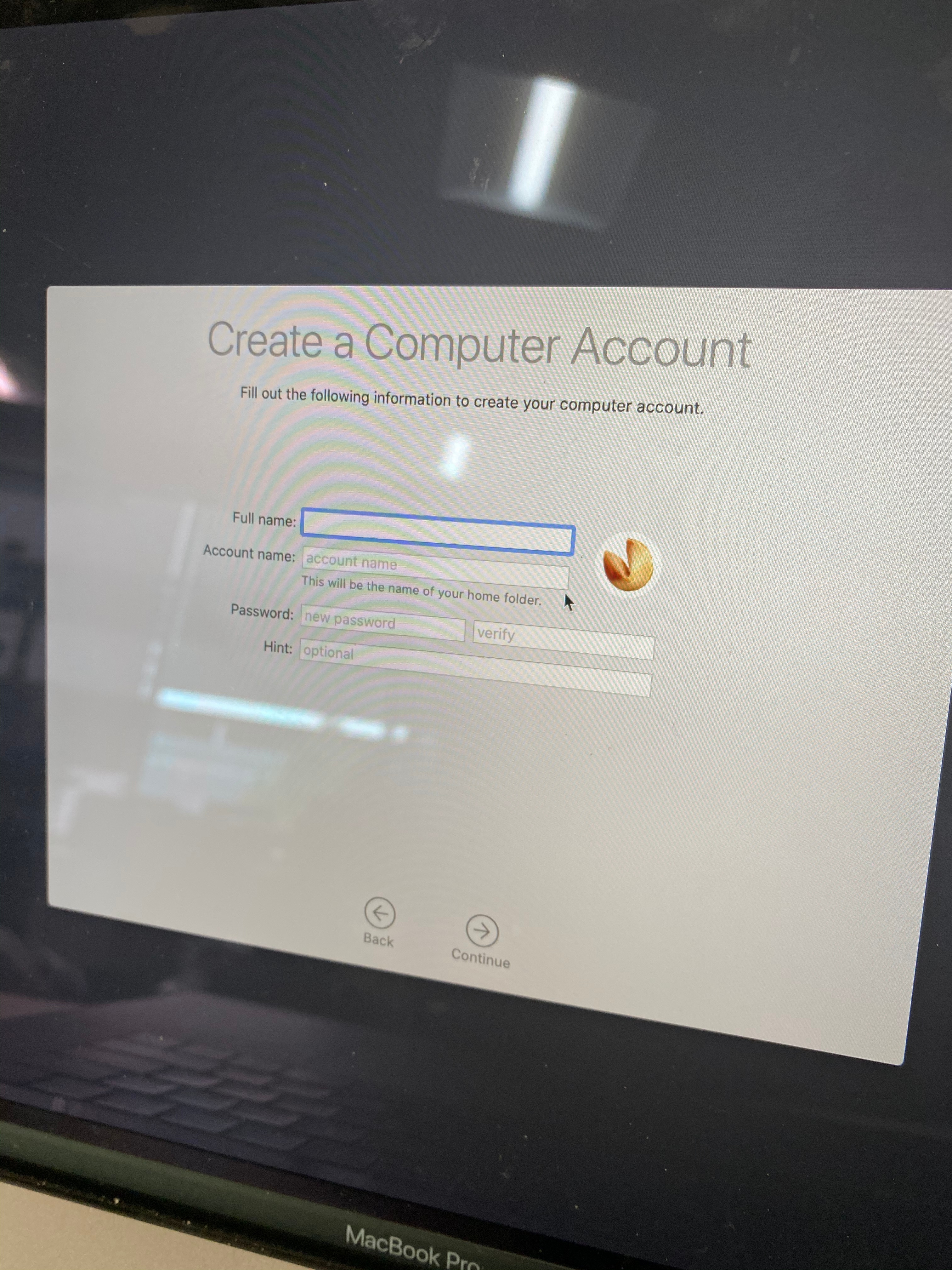

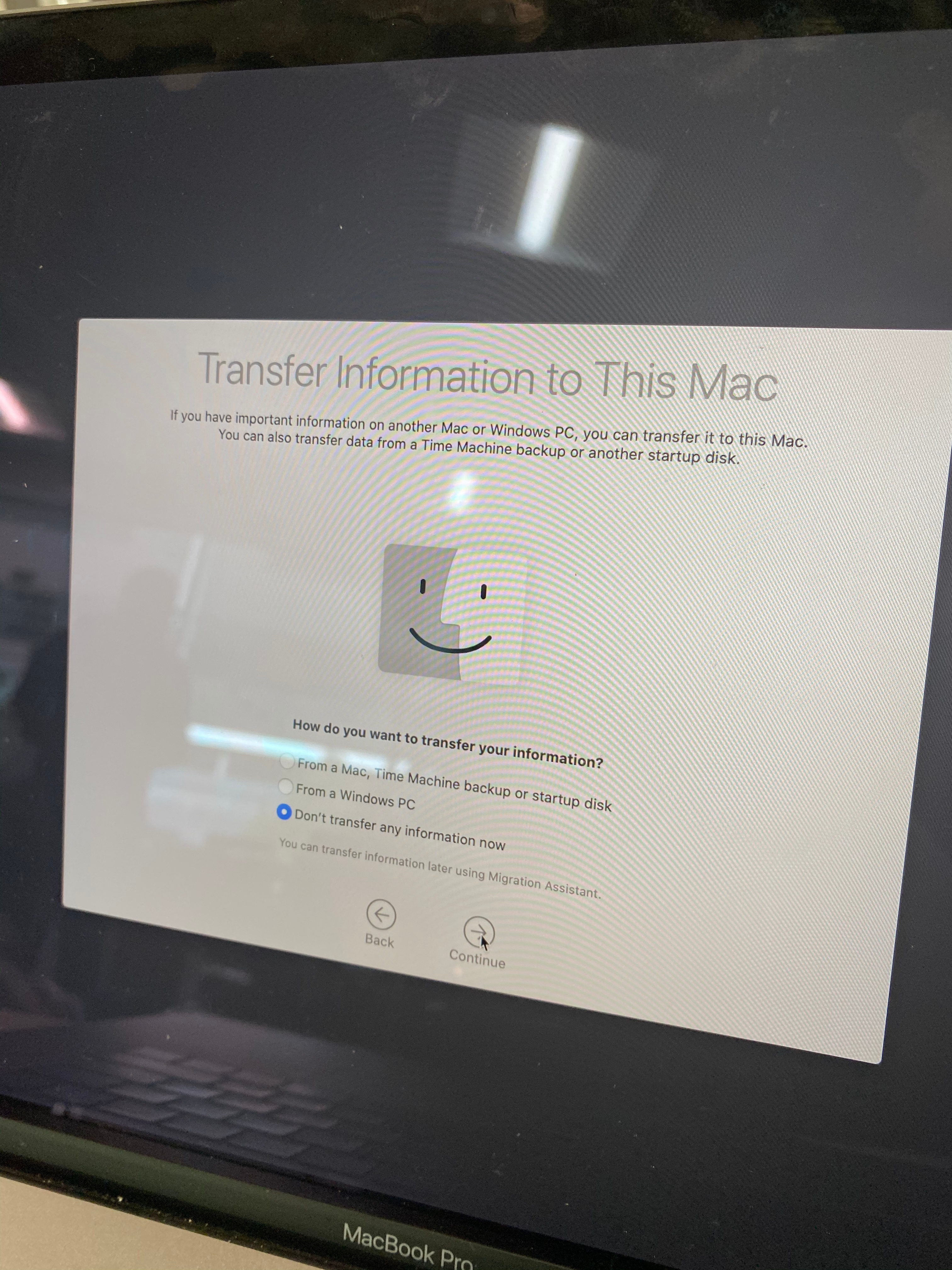

After a clean install of macOS Catalina, the device does not recognise that it is remotely managed. Instead after connecting to wifi (corporate or hotspot) it takes you to the usual setup steps for a brand new device, Transfer data, created local account etc...

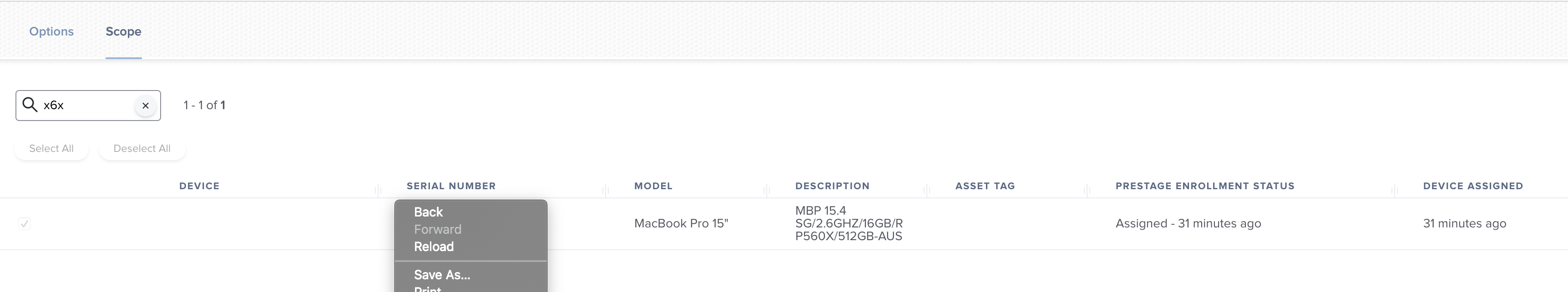

I checked the status of the device in DEP assignments, it was still marked as "Assigned"
I then deleted the computer record from JAMF, no change on device however the DEP assignments table now reports "Unassigned"
Logged into Apple Business Manager and assigned device to JAMF MDM, no affect on device.

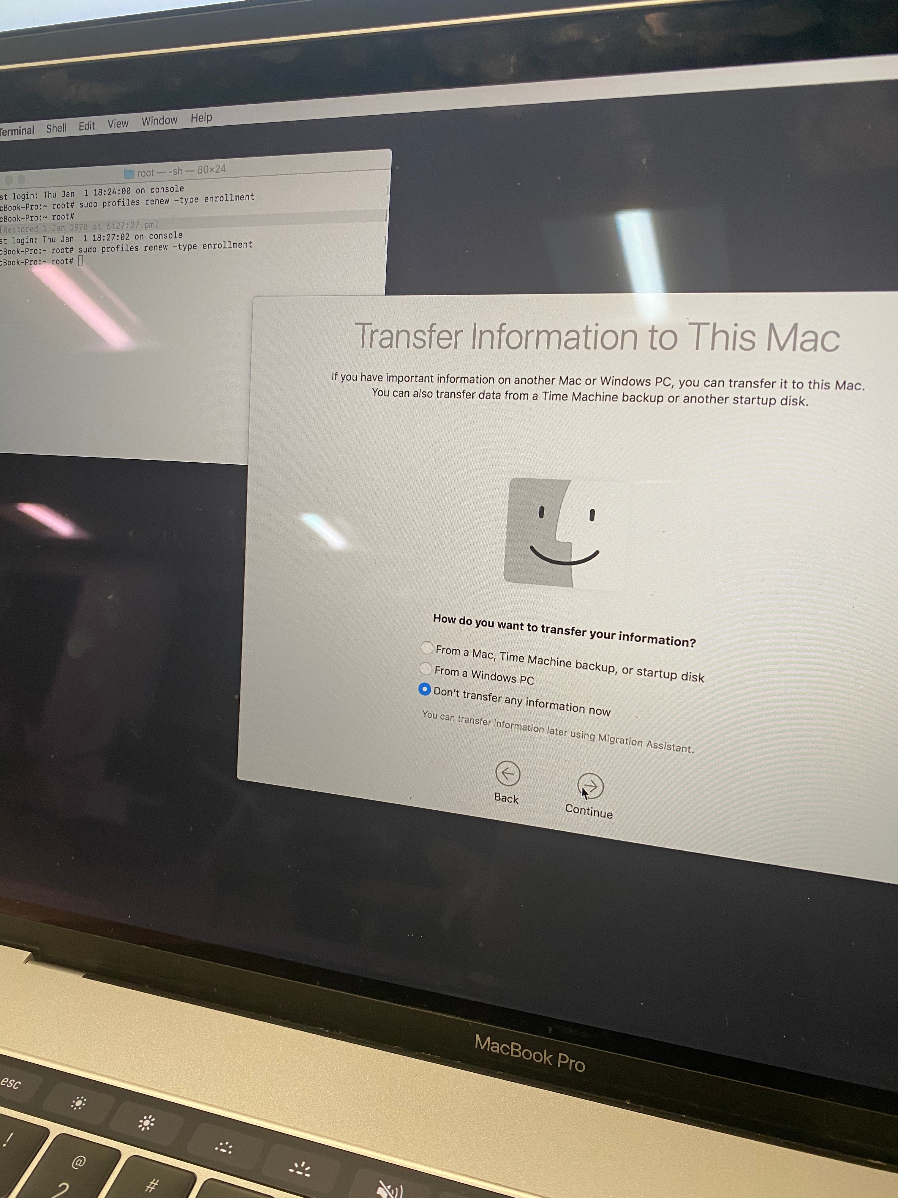

go back to the choose language screen. summon Terminal as root with ctrl opt cmd + t. type in “sudo profiles renew -type enrollment” and click return. Then Proceed with through the setup assistant again.

@joecurrinkys So I had a co worker whose setting up new laptops do this today and terminal pulled up as the root user and it worked for him. I also tried it on a test computer and terminal pulled up as _mbsetupuser and I was unable to sudo. I'm not 100% why one was able to be root and another was not.

Found a workaround (which I hate to even think about, thanks Apple!) Restart and at the very first screen for language choose yours and hit CTLR+OPT+CMD+T to get the root terminal, then:
sudo profiles -N
Setup the keyboard and now the management screen appears. Guuuuh! So much for Zero IT touch :(
@Swesymphony you were likely getting that "profiles: missing profile identifier" because of a syntax error. The correct command is
