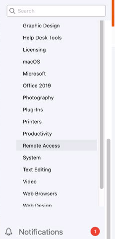

Having the exact same issue on some of our Macs. The only way I've found to get it to display the Categories is to scroll down and click on Notifications, then scroll back up to Browse click it to expand and it will display them again.

I did find that scrolling to notifications, then back to browse seems to work on my one afflicted computer, but it's only a temporary fix.

I noticed this on one of my test machines this morning. (It was a 2014 Mac mini that was running Catalina.) Scrolling and selecting Notifications and then Browse worked. However, if you collapse and re-expand Browse, the categories disappear again. If you don't see Browse at all, I noticed that reloading Self Service, selecting Notifications, and selecting the space where Browse is supposed to be displayed the notifications. This is a temporary solution as well.

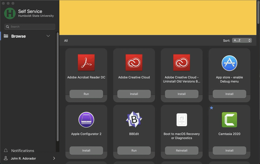

Scrolling has never seemed to help in my case. In my fleet of around 600 systems it either works or it doesn't. There's a wide variety of systems out there. On my sample of the 10 systems that I tested in my fleet:
• 1 is a M1 Mac
• 5 of the systems are macOS Mojave 10.14.6. One of these worked.
• 2 of the systems are running macOS Catalina 10.15.7. Both of these did not work.
• 3 systems (including the M1 Mac) are running macOS Big Sur. Two of these three work - with one running Big Sur 11.3 beta 2.
I tried finding a pattern on Saturday when I first encountered this in testing, but just could not find one. While working with Jamf Support yesterday, they had me remove the Self Service app and then I ran "sudo jamf policy" to re-install Self Service. I experienced the same problem again.
Here's an animated screenshot of what I'm seeing on affected systems:
