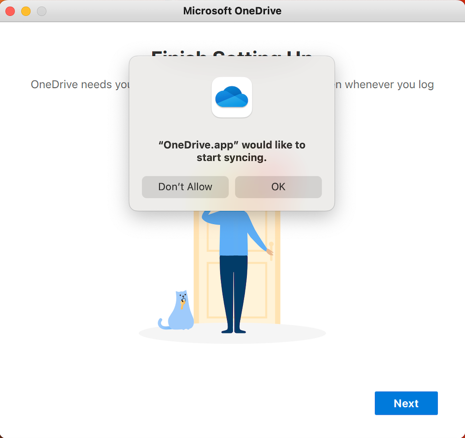

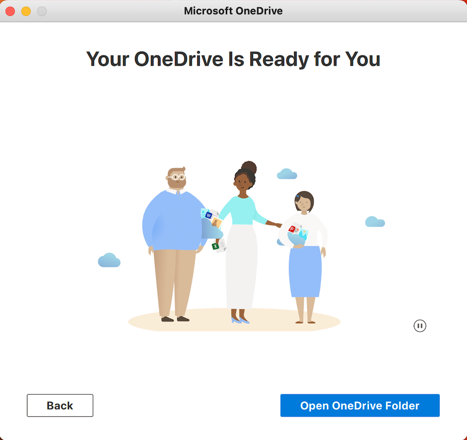

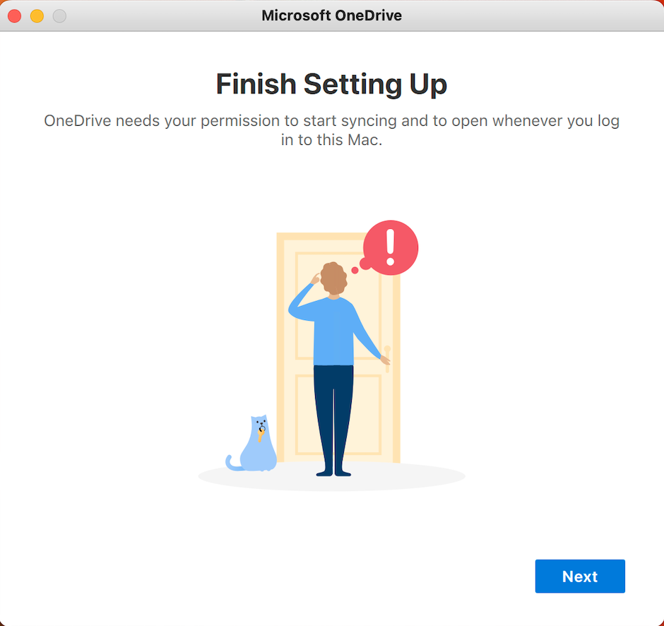

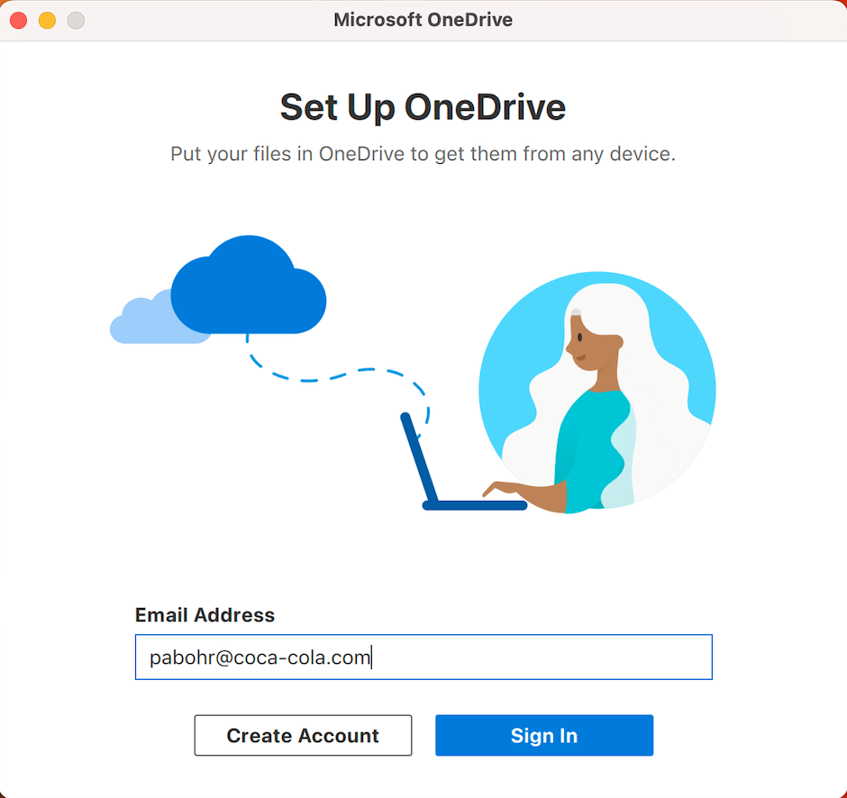

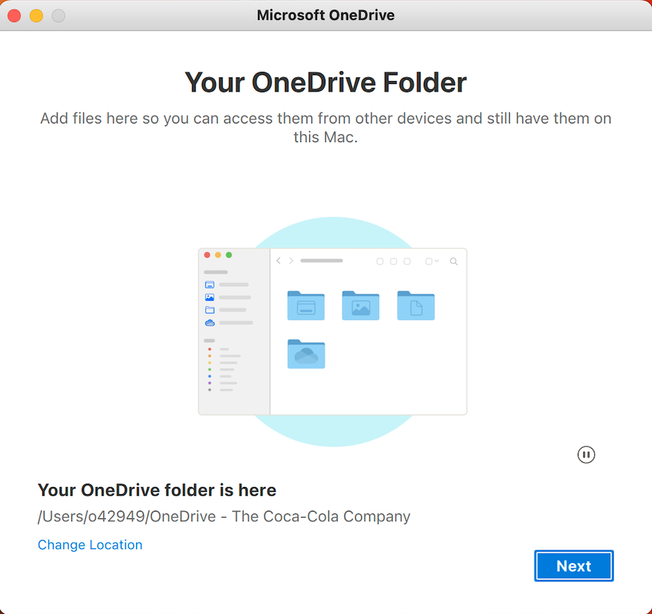

Can you share what happens when the user first opens OneDrive?
For us the user see the following screens:
  1. Your OneDrive Folder
  2. Sign In Screen
  3. Finish Setting Up - Your OneDrive needs your permission to start syncing and to open whenever you login to this mac
  4. OneDrive.app would like to start syncing
  5. Your OneDrive Is Ready for You

Seems that the user still has to login and setup some permissions. Is this what others are seeing?

@user-LTribFTuLL Here are the screens that are shown for us:
I believe it is the same as you.
Thanks I had hoped the user didn't have to sign in and agree to more permissions/syncing.

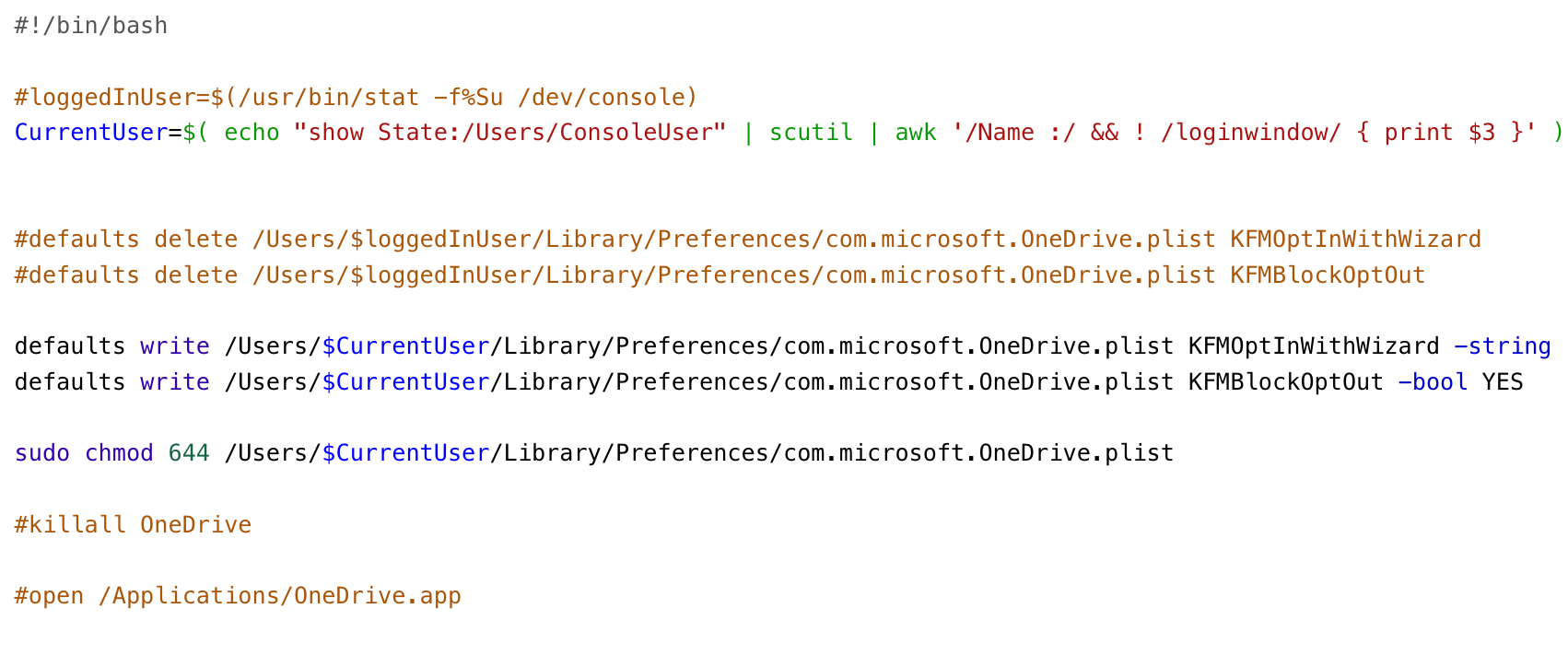

exec 2>&1
### Kill OneDrive application and sync process(es)
/usr/bin/killall OneDrive
/usr/bin/pgrep -x FinderSync | xargs kill -9
### Open OneDrive
open /Applications/OneDrive.app
