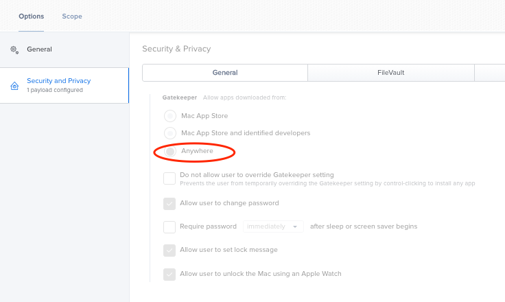

@fernando.gonzalez What command string from files and processes did you use to automatically run the DMG after it drops it in the designated folder?
I can deploy the policy and the installer file will drop in the Applications folder and I have it run this script '/Applications/Install macOS Big Sur.app/Contents/Resources/startosinstall --agreetolicense' but it will not run. I tried to launch the install file manually and it will not run because it says that Apple can't identify the developer.
  • Jan 8, 2021 3:25 PM UTC
@emadams Oh, I would definitely make sure that when trying to run the Big Sur installer manually that you don't get a "can't identify the developer" message. It shouldn't do that. You may want to re-download your installer.
Out of curiosity do you have a Configuration Profile for Security & Privacy scoped and if so is Gatekeeper set to "Anywhere"?

emadams
  • Jan 8, 2021 8:36 PM UTC
@fernando.gonzalez
That change worked perfectly! Thank you for the profile idea.
  • Jan 8, 2021 8:58 PM UTC
@emadams
I would not recommend reducing your security posture in this way as it allows the use of any application increasing the likelihood of malware and virus’s proliferating across your estate.
