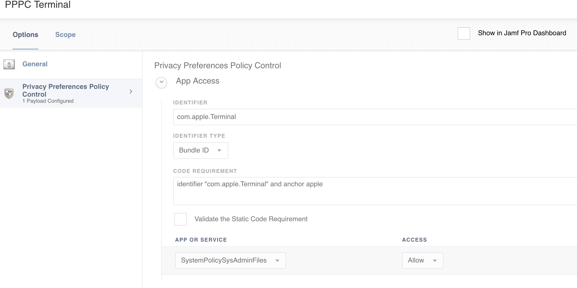

In my testing with DEPNotify and Catalina I noticed you also need to set Terminal with PPPC profile to access SystemPolicyAllFiles
Maybe there's a better/safer solution

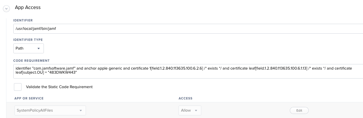

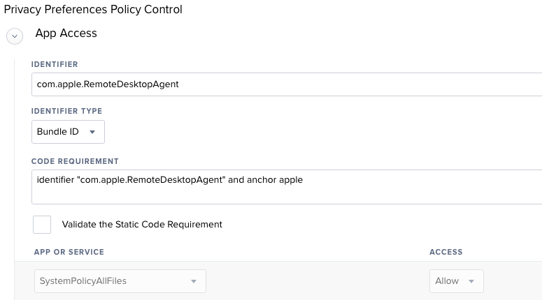

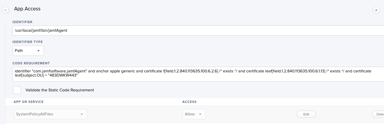

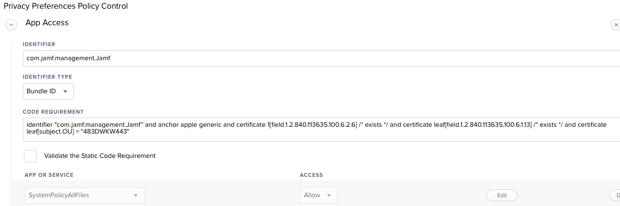

I would try messing with PPPC control having to do with Jamf binary and/or Apple Remote Desktop. I use ARD to run my policies so I don't have to wait for the policies to run on their own. So giving ARD access to All Files and Jamf access to All Files, finally allowed my policies to run again.

Staring to test Jamf Connect Login and using Notify during setup and getting this. I've added both bash and Terminal to a PPPC and still having the issue. Any ideas?

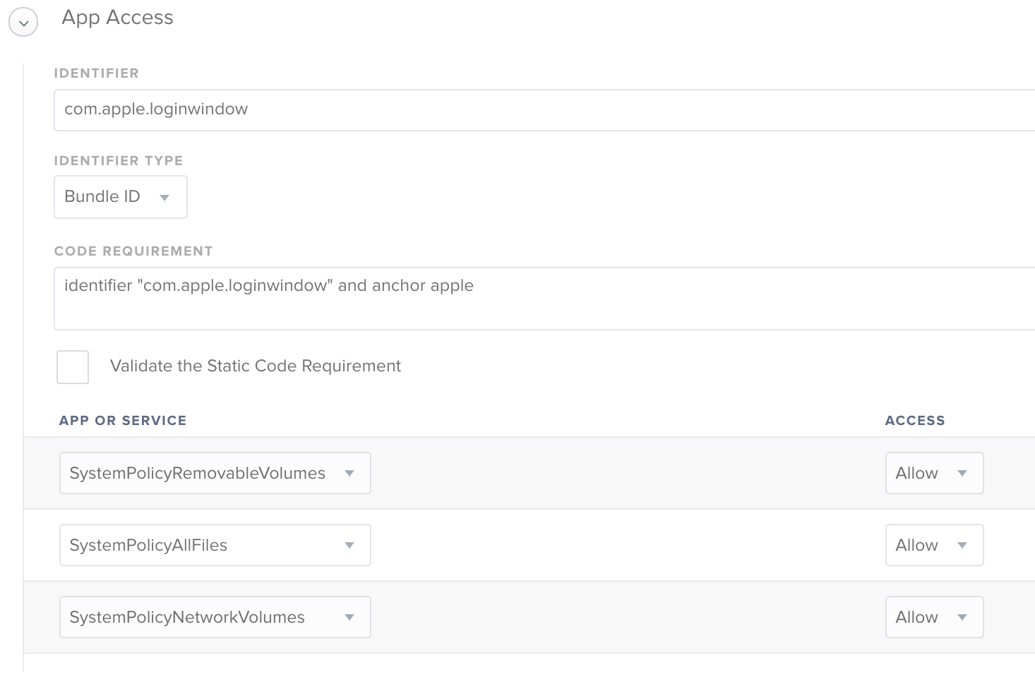

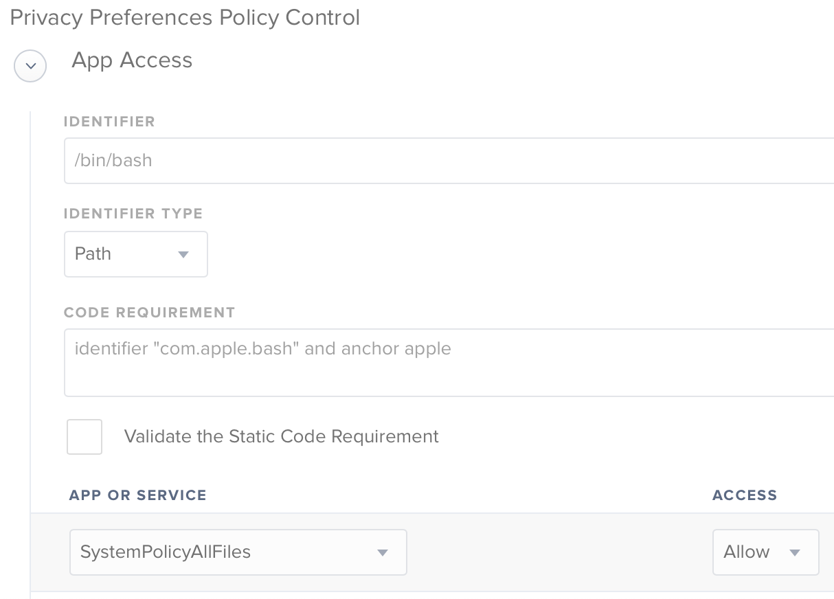

So this was frustrating but after looking at what process was actually running the login scripts I realized that the loginwindow owns the process. So if you create a PPPC for the com.apple.loginwindow bundle and give it SystemPolicyAllFiles and SystemPolicyNetworkVolumes it starts working. (Note you will also need to have defined a PPPC for jamf and also whichever shell you are using /bin/sh or /bin/bash)

After Reading @nate.barkei reply this morning I added to my Bash PPPC settings for com.apple.loginwindow and tested this morning. It worked great. No further need to run the http server on the mac mini to get everything to work.
  • January 14, 2020
WOW.... i ll do more testing but by giving PPPC on Terminal, BASH and login window... login trigger on Catalina works now !!!
