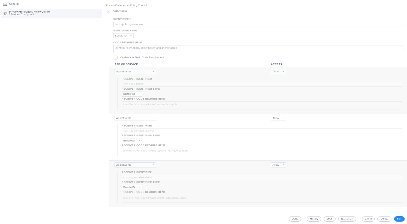

@brunerd Here's a screenshot of the final version of the config profile that did the trick for us.
After initially approving com.apple.loginwindow access to com.apple.systemevents I quickly discovered that additional prompts appeared requesting access to com.apple.finder and com.apple.systemuiserver, hence their addition to the profile.
As @bentoms mentions, I could also consider reworking our scripts to no longer include "tell application System Events". That'll be a project for another day
