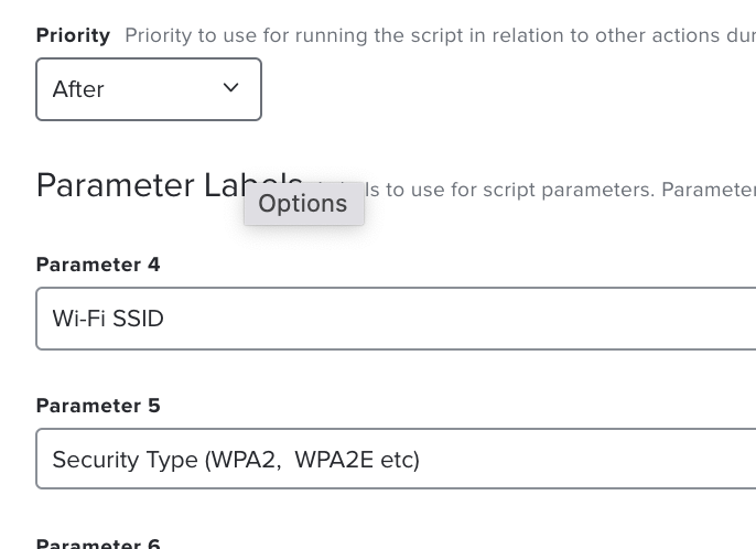

I'd like to be able to set the SSID in JSS. I know that this can be done by using $4, $5, $6 etc but what else is required in the script to get this to work?
# List of preferred SSIDs in priority order - edit/add/delete as needed
PreferredSSIDs = ["$4", "$5", "$6"]
sdagley
  • Jun 7, 2017 5:48 PM UTC
@MatG Sorry, didn't notice your question earlier. The $4, $5, and $6 parameters are directly accessible as variables in a shell bash script, but in Python you access them by using sys.argv[parameter#]. See this post for more info: Adding a Python Script to JSS

#!/bin/bash ############################################################## # Script : Orders Mac Wi-Fi ############################################################## # To order we remove and replace. Replace is always top of the list SSID=$4 Security_Type=$5 networksetup -removepreferredwirelessnetwork en0 "$SSID" networksetup -addpreferredwirelessnetworkatindex en0 "$SSID" 0 $Security_Type
We use this script and set the S4 & S5 values in the Script Parameters in the Script Payload of the policy.
The script removes and adds and when adding the network goes to the top of the list, even if you are connected to the Wi-Fi network being removed and added we see no loss of connection.
sdagley
  • Jan 21, 2022 4:04 PM UTC
@MatG That will break any 802.1x configuration that was in effect for the SSID.
  • Jan 21, 2022 4:34 PM UTC
@sdagley We have it in place on our Monterey devices and its not causing any issues and was thoroughly tested with numerous devices. We are not getting any reports of loss of connection.
