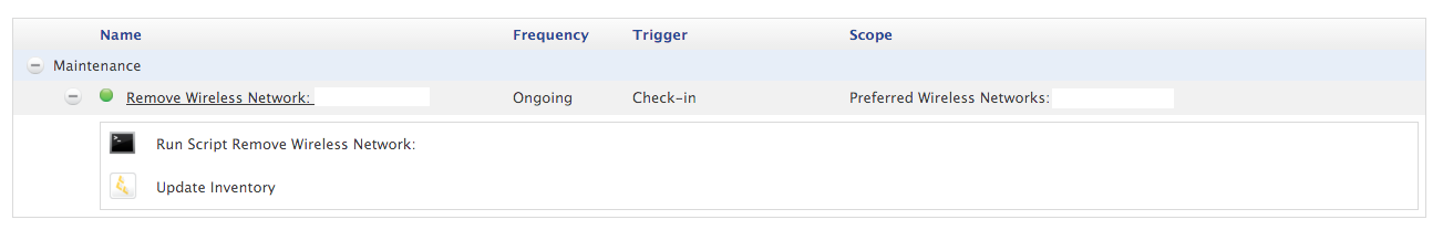

@mm2270 Perfect, that's exactly what I was attempting to do. I made a few modifications to the removal script --namely to remove the echo command that I was previously using--but believe this is good to go. Thanks!
