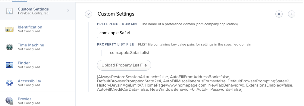

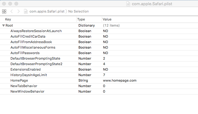

@jmercier Yeah that's what I was looking for. It looks like you uploaded the entire Safari plist to the the JSS. For custom settings profiles you'll just want the keys you are managing in the plist. So you'd create a new com.apple.Safari.plist and it would only have just the HomePage key in it.
Here is what the com.apple.Safari.plist looks like for our Safari environment.
and here's what it looks like uploaded to the JSS.

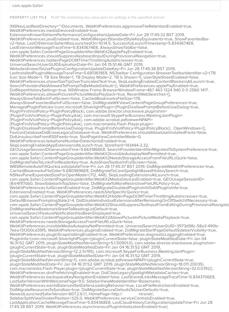

  • Jul 1, 2019 8:19 AM UTC
@ScottVV sorry for the late reply, but here is the attachment.
It is basically the Corporate Intranet site. It is now working on FireFox but still not on Safari.
The configuration Profile is set to Install Automatically & on Computer Level
Thanks
  • Jul 1, 2019 6:05 PM UTC
@k84 Thanks for posting the plist. The issue is probably that you uploaded the entire plist instead of just the entry or entries you want to manage. Take a look at my post above. Those are the settings we use in our student environment.
