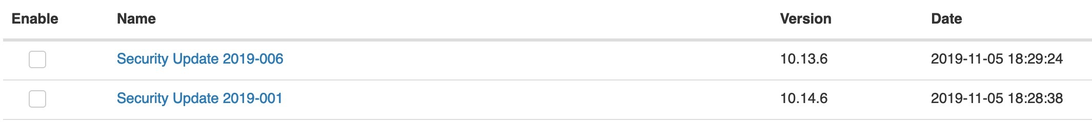

  • November 6, 2019
Seems like Apple re-released both Security updates yesterday (at least that's what shows on my NetSUS)

  • November 6, 2019
@carlo.anselmi, on Apple's website, it's still the one released on the 29th: https://support.apple.com/kb/DL2024?locale=en_AU

  • November 6, 2019
@cbd4s
Yes, it has happened the same in the past.
That's the pkg you can download directly from Apple website and it usually takes longer to see a more recent date/pkg there
The update available when running software update (from terminal or System Preferences) should be changed the same way it has changed when you update NetSUS/local Apple Software Update Server catalogs
