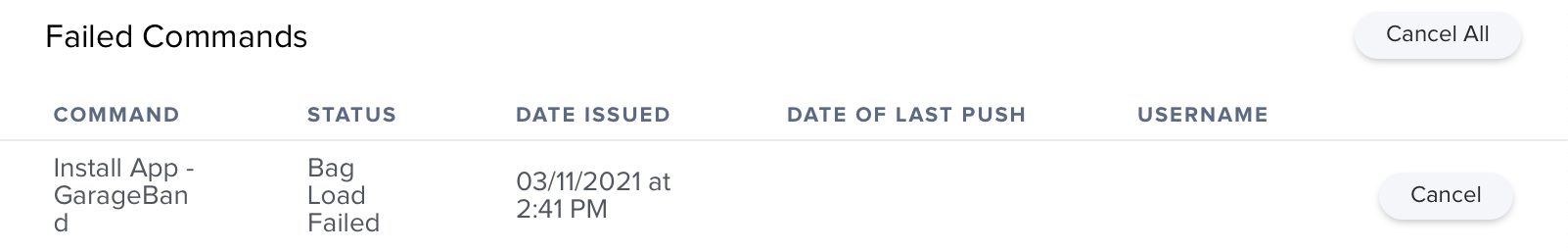

I just wanted to put up this PSA for folks who use Securly for filtering web traffic. I found last week that my Big Sur machines were no longer able to install VPP apps. We would get a strange "Bag Load Failed" error in the JSS logs. Once I removed the profile the apps installed with no issues.
Securly is aware of the issue and says they will let me know when they figure out whats going on.

we are seeing the exact same issue and have raised a case with Securly. Same story, they gave us a test pac script that was supposed to bypass their proxy and the behavior was still the same. Hoping to get a fix for this soon
Same to us - with a set proxy.pac VPP Apps can be installed in SelfService (only for Catalina) - but with BigSur we get the same Message "Bag Load Failed"

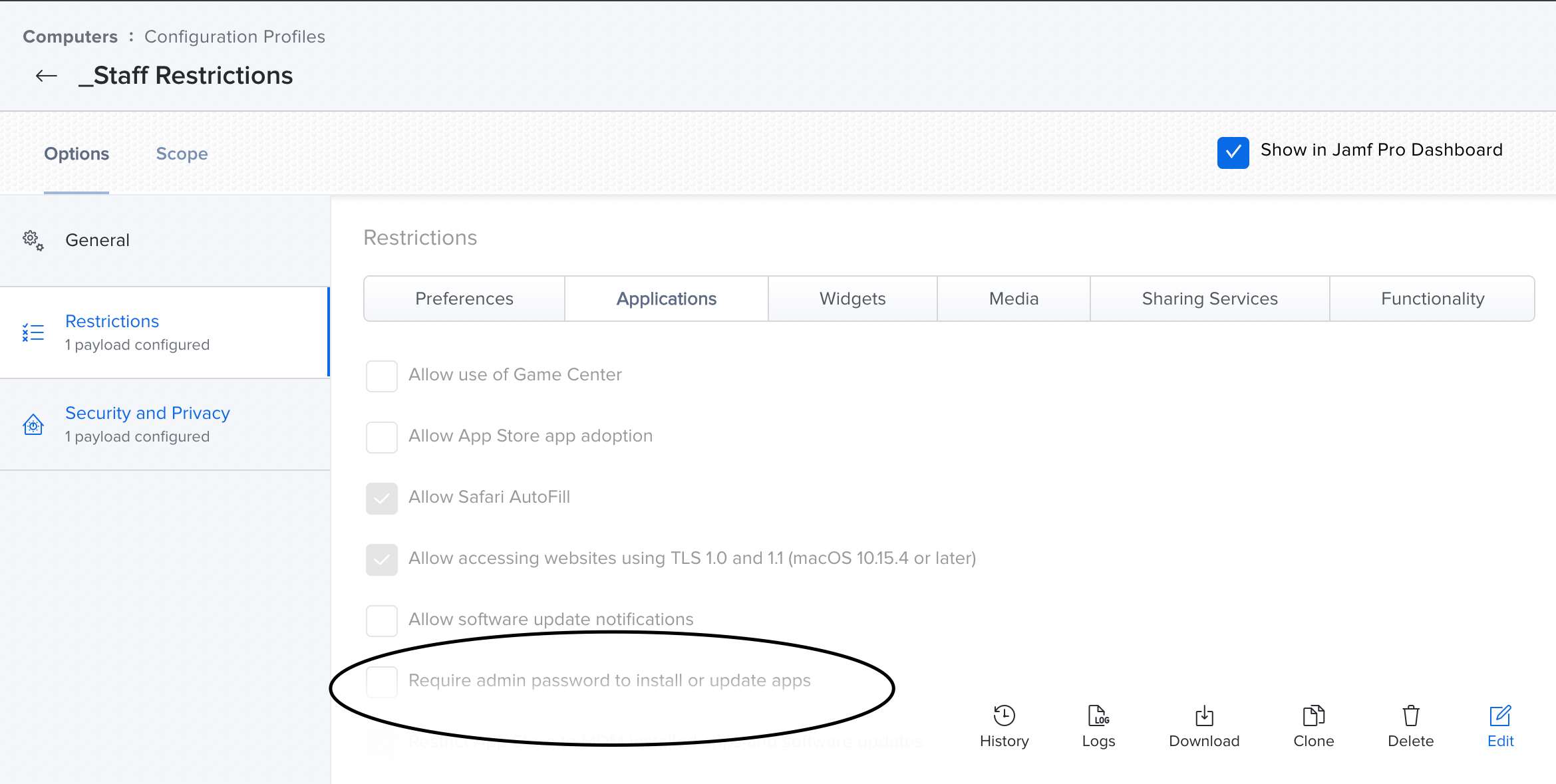

  • May 14, 2021
@atlantamacguru It ended up being our config profile causing it not to download. Ended up having to uncheck "Require admin password to install or update apps" on top of your script. All is good now with loading pages,numbers etc. Thanks for the help!!

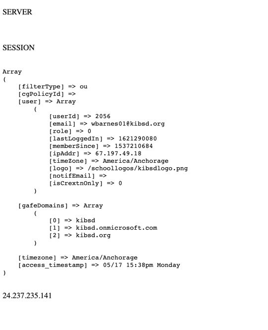

Has everyone had success with adding the PAC URL via script instead of config profile? We have this in place since we are in the process of swapping staff laptops to brand new M1 laptops but what we are seeing is everyone hitting the base/default policy. Our pac URL uses the variable $EMAIL to determine the user the device is associated with and it seemed to be working correctly when in a config profile. This is our PAC URL: https://www.securly.com/smart.pac?fid=*&user=$EMAIL . The Asterisks are just where I removed our company identifier likely not even necessary. Attached is a photo of the browser output of www.securly.com/auth/session which normally is able to output the AD user as well as the OU they are a member of. Currently that info is blank
  • May 17, 2021
This is the browser output when deployed via config profile, Stephanie Taylor is the user this example machine was assigned to.
Array
( [email] => wbarnes01@kibsd.org [useremail] => stephanie.taylor@kibsd.org [role] => 3 [hasValidateFID] => true [safeGroupName] => - [cgPolicyId] => [hash_extn] => :sonx:sgnx:stephanie.taylor@kibsd.org [user] => Array ( [userId] => 2056 [email] => wbarnes01@kibsd.org [role] => 0 [lastLoggedIn] => 1616433060 [memberSince] => 1537210684 [ipAddr] => 67.197.49.18 [timeZone] => America/Anchorage [logo] => /schoollogos/kibsdlogo.png [notifEmail] => [isCrextnOnly] => 0 ) [gafeDomains] => Array ( [0] => kibsd [1] => kibsd.onmicrosoft.com [2] => kibsd.org ) [schoolFID] => wbarnes01@kibsd.org [timezone] => America/Anchorage [access_timestamp] => 03/22 09:23am Monday
  • May 18, 2021
Looks like for whatever reason the setautoproxyURL is leaving out the $EMAIL variable but laying down the rest of the URL. Trying to figure out why thats happening now.
  • May 18, 2021
This was the final solution for us:
!/bin/sh
networksetup -setautoproxyurl "Wi-Fi" "https://www.securly.com/smart.pac?fid=**&user="$3"@kibsd.org"
When ran locally the $EMAIL variable was not functional so I switched to $3 with a login trigger and this seems to be working

  • October 15, 2021
I'm having this issue but never had that option checked
