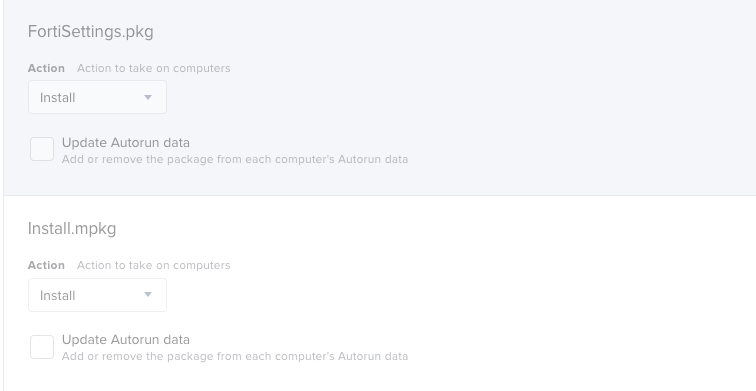

I have seen that the FortiClient is causing difficulties for some users. However, I have just been able to create a relatively simple solution with which the config files can also be made to work by default.
My requirements:
macOS 11.2.3 (intel) / Jamf Pro / DEPNotify 1.1.6
  1. complete installation on one system
  2. upload the install.mpkg to Jamf Admin
  3. start Jamf Composer and create a pkg with the following path incl. all subfolders (all custom settings are saved here): /Library/Application Support/Fortinet
  4. new policy: select both pkg-files, I first selected the config-pkg and then the Install.mpkg.
That´s all. I had success with this. FortiClient is running perfect with custom settings. No restart needed.

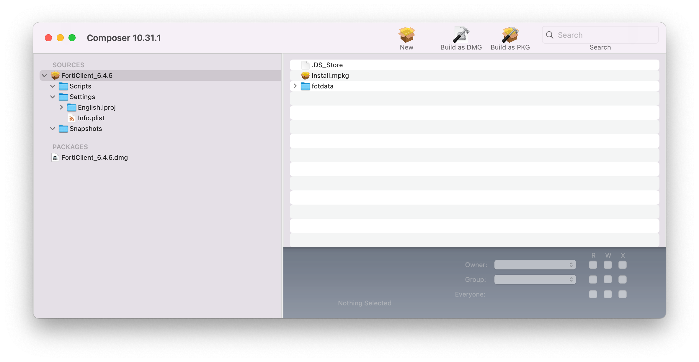

Repackaging the dmg from EMS to run the install.mpkg with the fct_data does the same. How are you handling the configuration profiles for PPPC/System Extension and possibly WebFilter?
How did you repackage? Just in Composer like this?
Mine doesn't seem to work.
  • Dec 3, 2021 3:29 AM UTC
  This is what I created, however doesn't want to install.

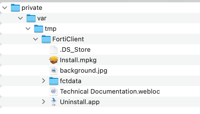

Does your post install script call the installer? I just drop the non-flat package and other files from their DMG into a directory inside of tmp and just call it with a post install script similar to the below:
installer -pkg /private/tmp/FortiClient/Install.mpkg -target /

the new way we currently go: the whole DMG file, which also holds the preferences, I package as a PKG, put it in private/var/tmp and then there is a command that starts the installation: in the payload files and processes the following command:
installer -allowUntrusted -pkg /private/var/tmp/FortiClient/Install.mpkg -target /Applications/
This has worked very well so far.

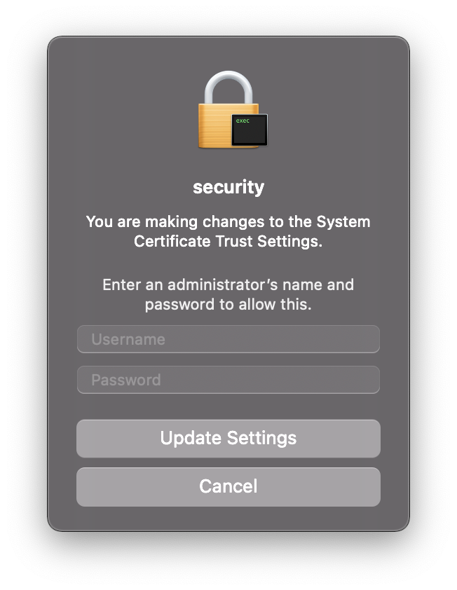

For users that aren't admins, some are seeing this is in our test deployment.  Is anyone familiar with this, and any way to configure it to not prompt users?
mickl089
  • Mar 10, 2022 8:42 AM UTC
I agree with the question, I also have this with almost every FortiClient installation.

My understanding is that Apple’s OS is designed with user engagement as part of the system security.  Maybe you’ll need a script to temporarily elevate account permissions so that the user can provide an account and password for the installation?  There are a couple of tools already scripted out there; I think Jamf even has a rights elevation script.
We have run into this with another process we’re running and that’s the only way around it.

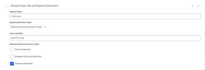

Just a quick update and info share for our free implementation of FortiClient 7.0.3.  Thanks to Mickl for providing the bulk of this process!
  • Deploy FortiClient 7.0.3.mpkg (pulled from DMG) via Composer pkg to custom folder on endpoint
  • Deploy custom vpn.plist via composer to /Library/Application Support/Fortinet/FortiClient/conf/ to endpoint
  • If upgrade, run a site acceptable variation of the following script
#!/bin/bash #Stops all running FortiClient processes killall FortiClientAgent killall FortiClient #Initiates silent uninstall of current Forticlient /Applications/FortiClientUninstaller.app/Contents/Library/LaunchServices/com.fortinet.forticlient.uninstall_helper #Run FortiClient 7.0.3 Installer installer -verboseR -pkg "/private/tmp/FortiClient_7.0.3_Source_Files/FortiClient 7.0.3.mpkg" -target / #Copy vpn.plist from tmp to FortiClient config folder cp /private/tmp/FortiClient_7.0.3_Source_Files/vpn.plist "/Library/Application Support/Fortinet/FortiClient/conf/"
  • If fresh install, create another policy to push FortiClient 7.0.3.mpkg to endpoint, then install vpn.plist, and add a maintenance item to update inventory
  • Create a smart group "FortiClient Installed" with criteria "Application Title Is FortiClient.App"
  • To hide client-side pop-ups (FortiTray popup untested at this time) create a configuration profile with both PPPCs and System Extensions as below, and scope it to "FortiClient Installed":

Create a new directory wherever you want it to reside using composer. Take the .dmg installer and convert it into a source and rebuild it as a package.
In mickl089's example, 'private/var/tmp/FortiClient' and dump the contents of the .dmg in that directory.
Have your post-install script invoke the install. Just make sure you have it in the same directory.
