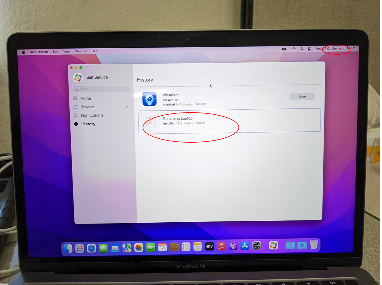

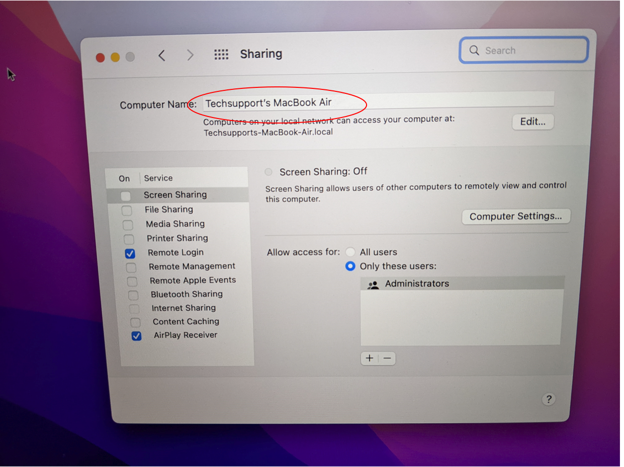

Hi @howie_isaacks ,
The script did not work.
After the enrollment, Iwent to system preferences, sharing, and it named the computer with; (User)Macbook Air. It look like this;
And I have this weird name on the top right screen.
Any other suggestion please? Thanks!
Hi @howie_isaacks ,

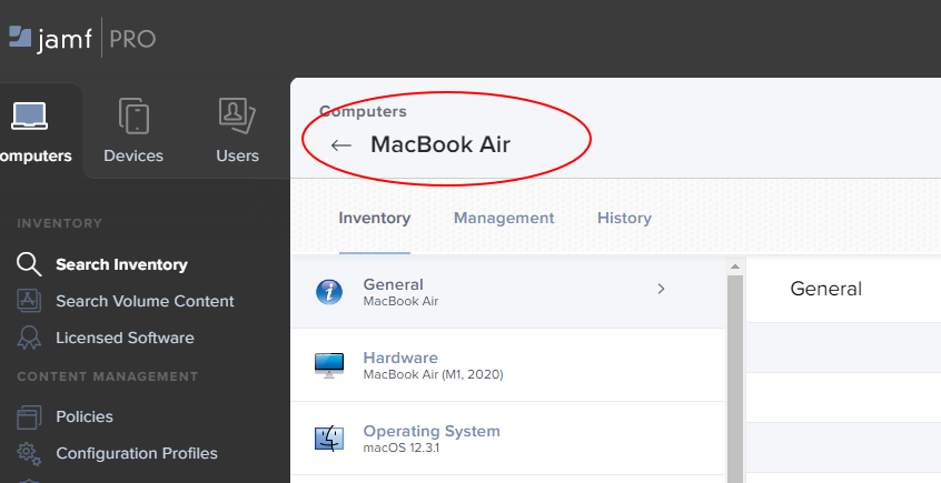

Also, this is the name that registered on Jamf Pro
