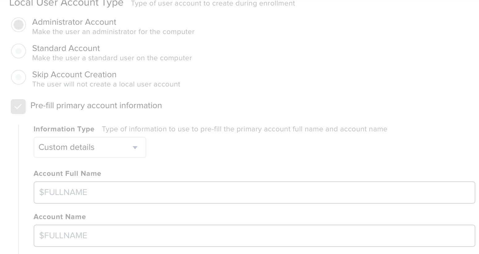

In the picture is how the account creating is setup. The staff enters the Gmail and the password for Gmail. It makes a user account based off that. No icloud account are logged in.

So I figured out the issue in our prestage enrollment. The home
directory/username had a space between first and last name. So the macOS
will flip out. I would try checking that under users and groups.
