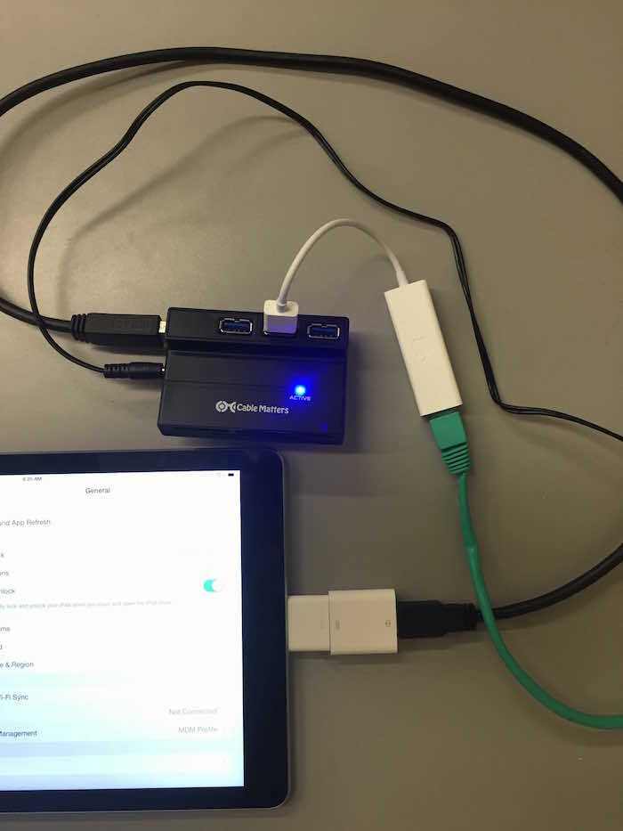

@St0rMl0rD We've had success with this setup but don't believe it's officially supported by Apple. Important to note this works for us because we're not using 802.1x or a captive portal for wired connections at this time.
Apple USB Ethernet adapter
iPad Camera connection kit
Lightning to 30-pin Adapter
Plug the USB Ethernet adapter into powered USB 3.0 hub. I don't think you need to use a 3.0 USB hub but that's all we had for testing.
Connect the USB hub to the iPad via the Camera Connector adapter.

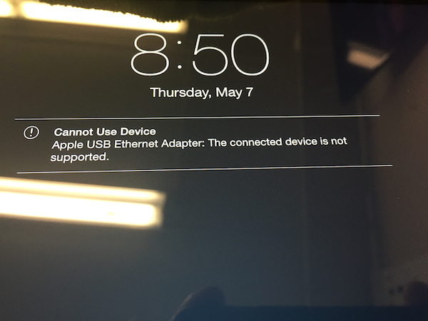

I've successfully tested the Clear Passcode command with a DEP enrolled device and this USB Ethernet adapter setup. I can also confirm same setup worked to clear the passcode if the iPad was in Airplane mode or WiFi was off.
You will see the following erroneous message on your iPad: Cannot Use Device - Apple USB Ethernet Adapter: The connected device is not supported.
The iPad is able to connect to APNS and our JSS.

Yes, the ethernet method works, but it's not officially supported and it may stop working at any time in one of the future iOS updates. We need an official, Apple supported way of doing this.

You're correct Apple doesn't officially support the Ethernet rig, but it's been available since iOS 6 (I believe) and it's the only method that'll get you into the device short of wiping it. I would imagine Apple's official response will be you need to wipe the device.
If you have to purchase every part for the rig, you're looking at under $100. You may already have a USB hub (consider using a monitor with built-in USB) as well as the USB to Ethernet adapter. The camera adapter isn't too commonly used in IT but it's a $30 investment that will pay for itself if that's all you need to purchase.
