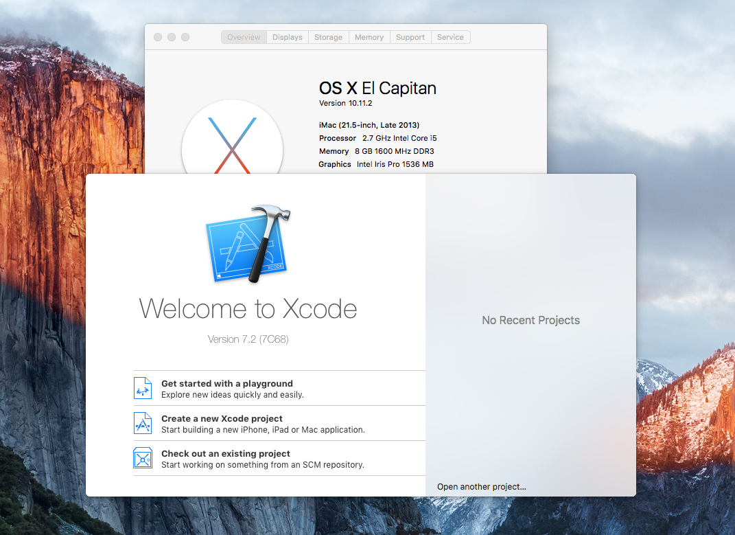

AVmcclint
Forum|alt.badge.img+21
  • December 10, 2015
After reading this post I figured I'd test deploying xcode 7.1.1 to my 10.11.2 tester Mac. I'm using the same .dmg and post-install script that I use on our Yosemite Machines. I watched as it copied the 9GB .app to /Applications and then it ran the script (very similar to @bpavlov's script) and then Self Service said it failed. I checked the log and it also says it failed, but I can't find any indication of actual failure.:

I launched XCode and was quickly brought to the "Welcome to XCode splash screen" No prompts to install components appeared. All actual proof says the install was successful, but for some reason JSS 9.81 says it failed. Again, this is the exact same Policy that I install on Yosemite Macs and none of them show up in JSS as Failed. I'm getting real tired of "failures" that aren't actual failures.
