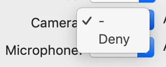

Some of us have taken a closer look at the binary and seen some things we don't like (possible remote control of the camera, for one?) this is impossible. You cannot pre-approve camera or microphone access. If I'm wrong please let me know because I have to deploy voip software and getting our users to click the "allow access to microphone" button is surprisingly hard.
think you can do it with PPPC tool or something. I also can be wrong.
Nope, for Camera and Microphone specifically, the only options available in the PPPC Utility, and therefore within Apple's MDM framework itself, is Deny. You cannot pre-approve allowing access (just pre-approve denying access) to either of those for any other program or binary.
Therefore Jamf cannot give access to these. It may have been able to do so in the past by deploying some 3rd party utility or hack to enable it (it was NEVER something built-in), but with Apple's recent security model changes, even that is now impossible. The user is the only one that can allow it to happen.
With the changes Apple made to user data protections in macOS 10.14+ there is no way to enable camera or microphone for applications remotely, it requires end users allow it via the prompts. The PPPC tool only shows the deny option for Camera and Microphone. Also the Jamf binary never had the ability to enable the camera. There might have been some previous discussion and comments around it but the feature was never added. #rasingthreadsfromthedead
