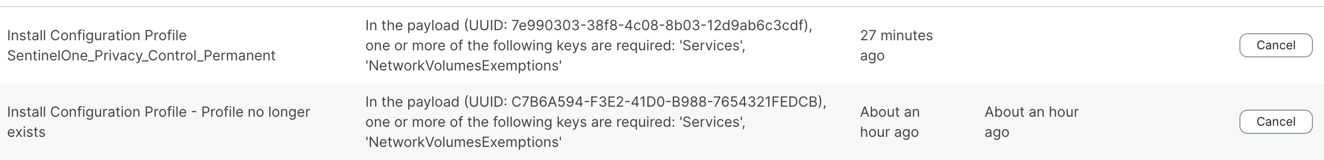

This results in the configuration either
  • Failing, as the pushed config is invalid (ignore the UUIDs; different attemps)
  • Finishing, but missing the required part of the payload, meaning that the agent is misconfigured
