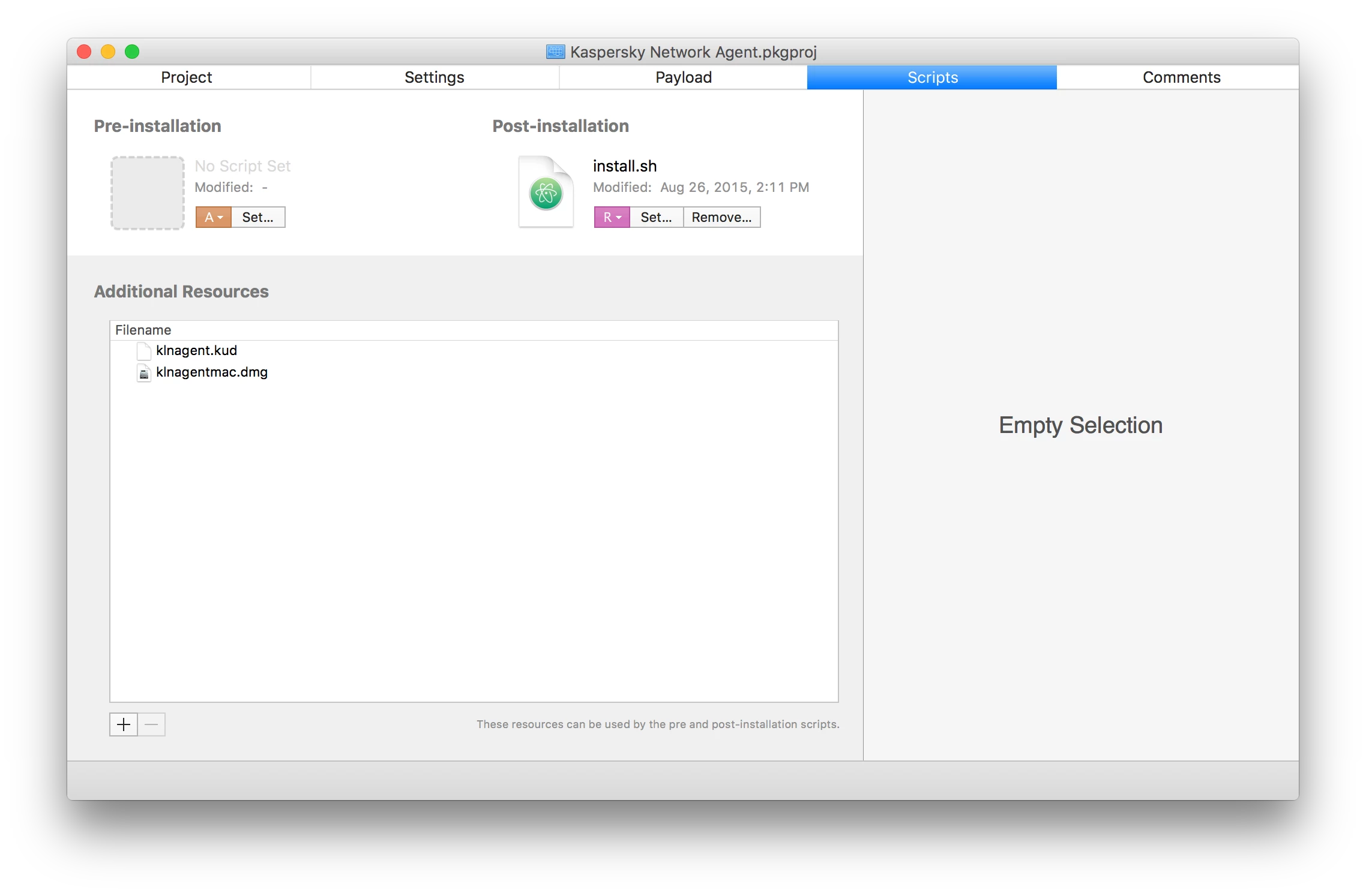

I follow the same basic layout as @canopimp.
Kaspersky Network Agent
I add the necessary info into the install.sh variables, then add the files into Packages as depicted.
Kaspersky Endpoint Security
Since their install.sh file takes parameters, I create a postinstall.sh file that simply calls install.sh and add the files into Packages as depicted.

mscottblake
  • June 15, 2016
@garyj
Yeah, install.sh takes parameters and if it's run as a postinstall, Installer.app will pass a few things to it, but they are not the values the script is expecting, so it fails.

mscottblake
  • July 28, 2016
@niacobelli If I remember correctly, the only thing I have to change is in the Network Agent package. Near the top, the IP_ADDRESS field gets the address to the KES server.
In my case, I have IP_ADDRESS=kes.domain.com/site

@mscottblake] what is the program you are using in your screenshots to create your packages/scripts?
thanks - ernesto
mscottblake
  • October 20, 2016
@eflores I use Packages for most of my packaging needs.
