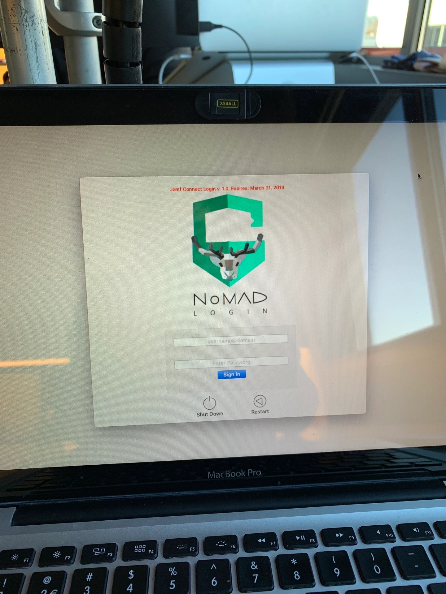

I've reset the authorizationdb using /usr/local/bin/authchanger -reset -Okta, after that the login window changed to this:
But now the log states:
2019-02-15 14:13:50.379036+0100 0x21e8 Error 0x0 712 0 SecurityAgent: (JamfConnectLogin) [com.jamf.connect:CheckOktaMech] Unable to get Okta Server

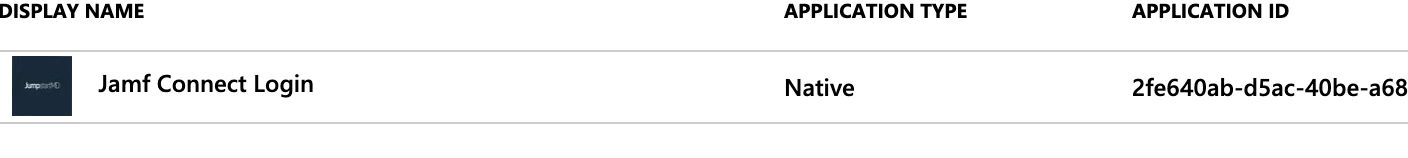

I think it has to do with adding a native custom application to Okta, but can't find out the URI's for authorization. Maybe this helps with AzureAD as well..

I ran into this issue as well, but with Okta. I was trying to figure it out on my own for a couple of weeks. I finally reached out to Jamf support and had them look over the plists I created for both NoMAD Pro and Jamf Connect Login. It took them a few days as well, but they did end up getting me a resolution today. It seems that there was a key missing (that I didn't come across in any of the documentation) that identifies the Okta as the IdP. The key is below and needs to be added to the com.jamf.connect.login.plist you create for Jamf Connect Login.
<key>OIDCProvider</key>
<string>Okta</string>
I had to refresh the login window a few times after the new config profile was push out but it ended up connecting to Okta. The support tech also advised to put "authchanger -reset -Okta" in the Execute Command section (Files and Processes payload) of the app policy. I would presume that the same could be achieved for Azure if you substitute the "Okta" values with "OIDC". Hope this helps!

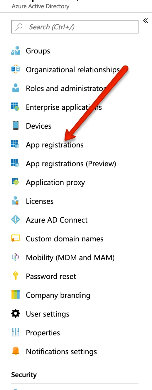

Have you logged into portal.azure.com and added to app registrations?

If you're using Azure AD, I'm going through this right now and you don't need to use the two PLIST files that talk about AuthServer. You just need to use the on named com.jamf.connect.login.plist and com.jamf.connect.verify.plist
You'll need to have created the Azure App Registration outlined here:
https://docs.jamf.com/jamf-connect/1.0.0/login/administrator-guide/Integrating_Jamf_Connect_Login_with_Azure.html
You'll use the values from the Azure App registration in those PLIST to set the OIDCClientID and OIDCROPGID
