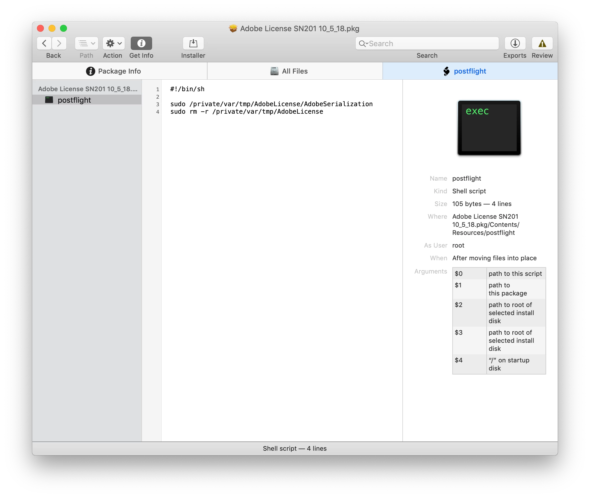

Here is what my package looks like. The sudos are overkill, but it all works for me.

mvu, the screenshots helped a lot to visualize the structure, much appreciated. What software are you using to make those edits? I did mine in Composer but it didn't look like that.
I used Composer to build the package + postflight script and then dumped it into an app called Suspicious Package (what you see in screenshots).
https://www.mothersruin.com/software/SuspiciousPackage/get.html
